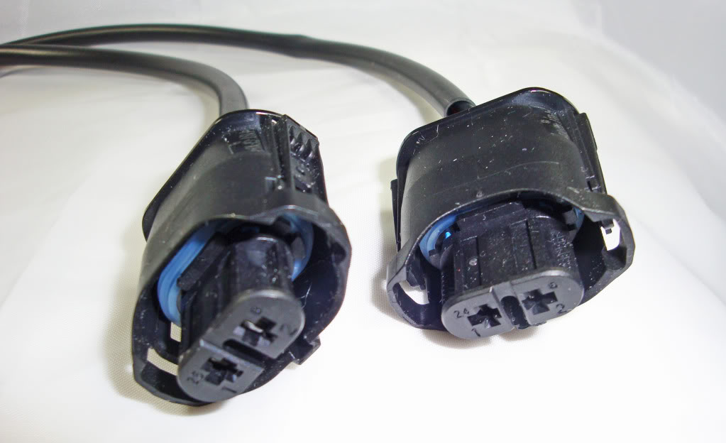

The front fog lamp connectors on your facelift D2's main harness, are this type, which are an AMP/TE female H11 bulb connector -
To connect to them, you will need a mating male connector.
AMP/TE don't make a male connector in this series - but, our good friends in China do make one Name:  chinese.gif
They're available from various sellers on eBay, here's the one I linked to in the other thread -
2X H8 H9 H11 880 Male Connectors Connector HID Free Ships from USA | eBay
The factory wiring for the D2's front fog lamps, is in 1.5mm² cable, which is rated at 20A.
2 x 100W lamps will draw 16.66A @ 12V - so, the factory wiring will be OK.
You will need to change F3 in the engine compartment fuse box from 15A to 20A.
