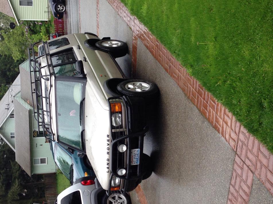

Thought I should share picked up near Seattle for 5 bills )
Safety devices full rack with clearance for sun roof
