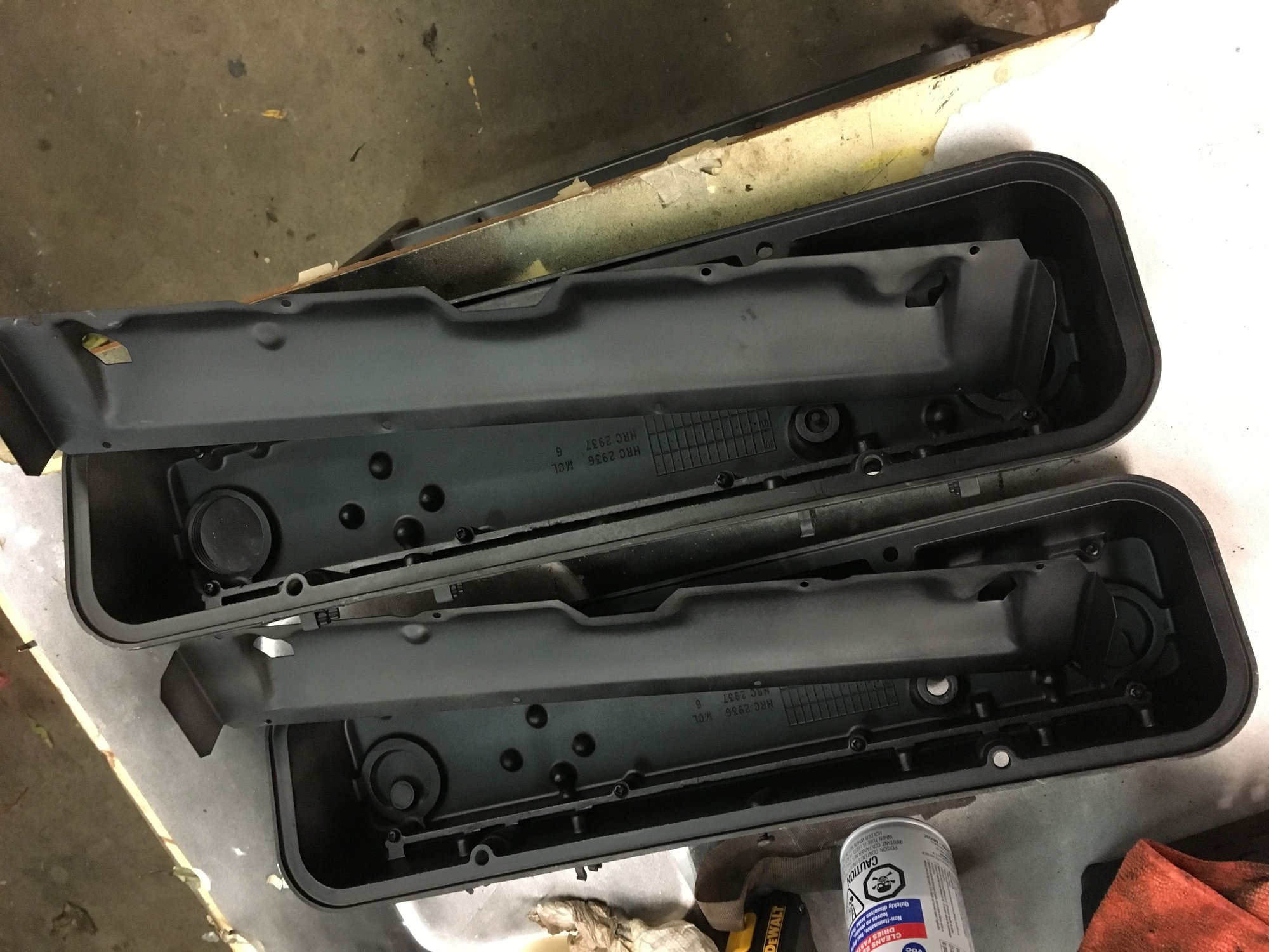

I too broke mine I soaked in brake cleaner gently punched out it was solid clogged passenger side was missing I had oil in my intake plenum, I also took out the separator plates in the rocker covers they were just caked doug on Atlantic British vid said if the rockers are clean inside It means the vehicle was maintained and oil changes done it’s a learning experience sometimes costly I’m a cleaner of parts I love a nice engine bay, back to the oil separator having broke mine I glued it back together it’s a tight fit should still work but ordered 2 more from LR Direct.

there's only supposed to be a baffle on the passenger side. driver's side is supposed to be clear, with no baffle.
