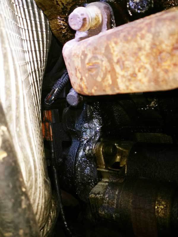

okay, pressure test from 15 to 0 takes about 8 mins and I have dripping. Tried to take a picture (think this thing is camera shy...) of the area in question.
can't tell where it's coming from, so I guess first step is open up to the valley pan and pressurize again... gonna have to go at least that far if it's head gasket

upper intake off... and I've got coolant at the back of the valley pan! Probably a combination of not enough RTV at the end gasket (didn't see anything about putting it under the end gasket before fitting) and probably not enough at the gap and above... gonna pressurize now and hope I see coolant flowing Yup... nice little puddle... never been so happy to see a puddle of coolant in my entire life! This whole thing is a lot easier to do the second time

Put engine cleaning foam on that area in the picture and
pressure wash it at the coin car wash.
You could just try to torque the intake manifold bolts back to spec.
Put Barr's leaks into it too. If Barr's leaks STOPS the leak - then probably NOT the
head gaskets.
If Leak persists with Barr's leaks then probably head gasket.
Changing the valley gasket is only 1/3 of the work of the head gasket.
You could do that first.
I did it in a parking lot outside.
So with your nice tidy garage have a go at it.
