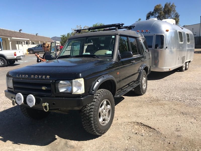

I have a 2000 Disco II. I am the original owner. It has 142,000 mile on it. I have taken very good care of it, servicing it regularly and replacing parts as it has needed to be. I have also added OME 2 inch lift, Hankook Dynapro MT tires, all Terra Firma bumpers, rock sliders, brush guard, and front and rear wide wheel arch fenders.
The engine finally gave out as it overheated and it is beyond repair according to the mechanic who has maintained it since the warranty expired. I can get a good used 4.0 replacement installed by The British Garage (formerly known as The Rover Group) in San Diego for about $5000. My wife thinks I should sell it off for parts. I love this rig and would prefer to install the engine and drive it for many more years. I figure I know its history and I probably cannot buy another disco that would be as dependable for the same price as putting in the new engine.
So here is my questions:
What would you do?
About how much would someone pay for a Disco that is not running?
About how much would someone pay fo the same Disco with a new engine?

Did he specifically say what is beyond repair since it overheated? Very few things would cause one of these to be beyond repair, I've been told I needed a new engine 3 times by various LR specific shops over the years. It was only true the 4th time.
The only thing that would make it non repairable is a cracked block which is what I finally had. That involved coolant getting into a cylinder, no overheating involved.
Overheating usually is a symptom of a bad cooling system or a head gasket failure. You don't mention if you've had the HG's done before. If not you are over the mileage that it usually needs done.
I would be getting a second and third opinion on this one. Unless there is more to the story...
Looks like a nice truck, hope your wife can understand why you would want to keep it.

Try to fill the D2’s shoes with a modern replacement Toyota 4Runner TRD comes to mind is 47-50k easy. So a new 5k engine or 10K Trailhead 4.8L LS swap for 10k is no where near that!! If any engines die for me to where I can’t repair it I’ll do an LS Swap from Trailhead and keep on trucking vs a 50k Toyota I won’t want to scratch or enjoy for years the way I enjoy my LR’s!

With all of the goodies, l'd say this rover would be in the $1000/$1500 range to an enthusiast...maybe more depending on location and condition of frame/body. For a rover enthusiast to drop a motor in her would be a couple days work and cost of engine, minor stuff.
Me, if the frame is perfect, l'd do the swap (Trailhead LS) and be done with engine issues for a long time.

Overheating is probably a blown headgasket, about a $1500 repair, but if you have it at the local LR shop then they obviously are not interested in the minimal cost repairs. I normally recommend only bringing LR's to LR shops, but sounds like your local shop is not helpful. You might consider buying the engine yourself and finding a shop that will do the R&R.
Your truck story is very good and I can understand why you would be reluctant to sell. $500-750 is normal for a Disco with a blown engine, but yours has several nice accessories so I would put the value at about $1500 to the right buyer. I would put the bumpers value at $500 front and $250 rear, your sliders are about $250, looks like you have $250 in tires on it. Transmission, transfer case, interior parts, etc. are another $500.
With a rebuilt/new engine I would put the value at $5000/6000. If it was mine I would figure out a way to keep it, but then I already have 5. My reasons:
