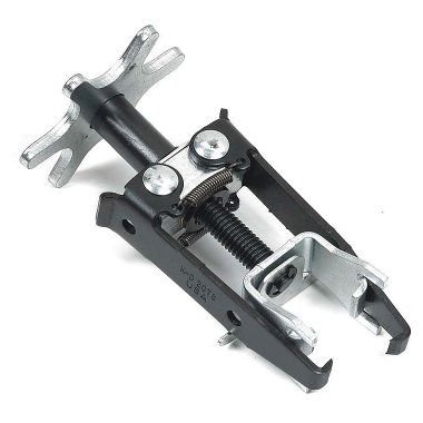

Pressurize each cylinder and use this tool to compress the springs. Not an assumption at all, I've done this and it works great for situations where you don't care to remove the head(s).
