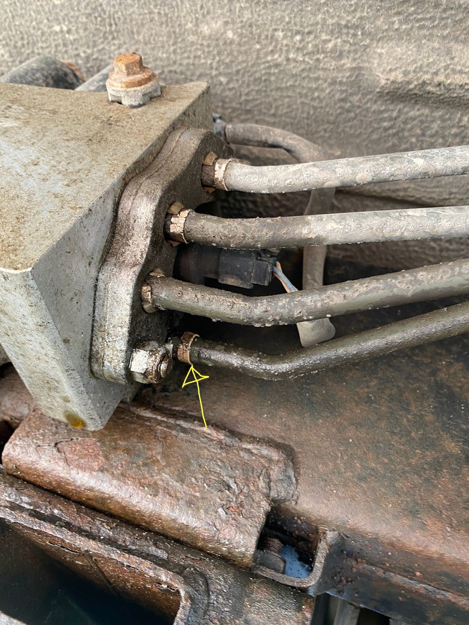

Leak is probably the result of the steel line degrading the aluminum valve block. If you feel comfortable, you can install this yourself, not hard, just cutting ACE lines with a tubing cutter and installing the new ACE Block rebuilt beautifully by this company:
https://www.designdevelopmenteng.co....ded-p389433934
I purchased it about 18 months ago, installed it and it works great. My symptoms were the same as yours. You can keep adding fluid temporarily, but a new block is what is needed. If you are not comfortable with the install, any competent shop can do it as well.

Ive I’ll to attach a pic displaying where I’m leaking. There appears to be a little, flimsy collar that has worked itself loose from the base of the one pipe and its “clip”, I’m guessing this collar acts as some sort of gasket?
just curious if I could “re-gasket” this pipe, if it would solve my woes.
still unsure as to why the fluid level drops and returns (as mentioned, this leak isn’t leaking like a sieve).
