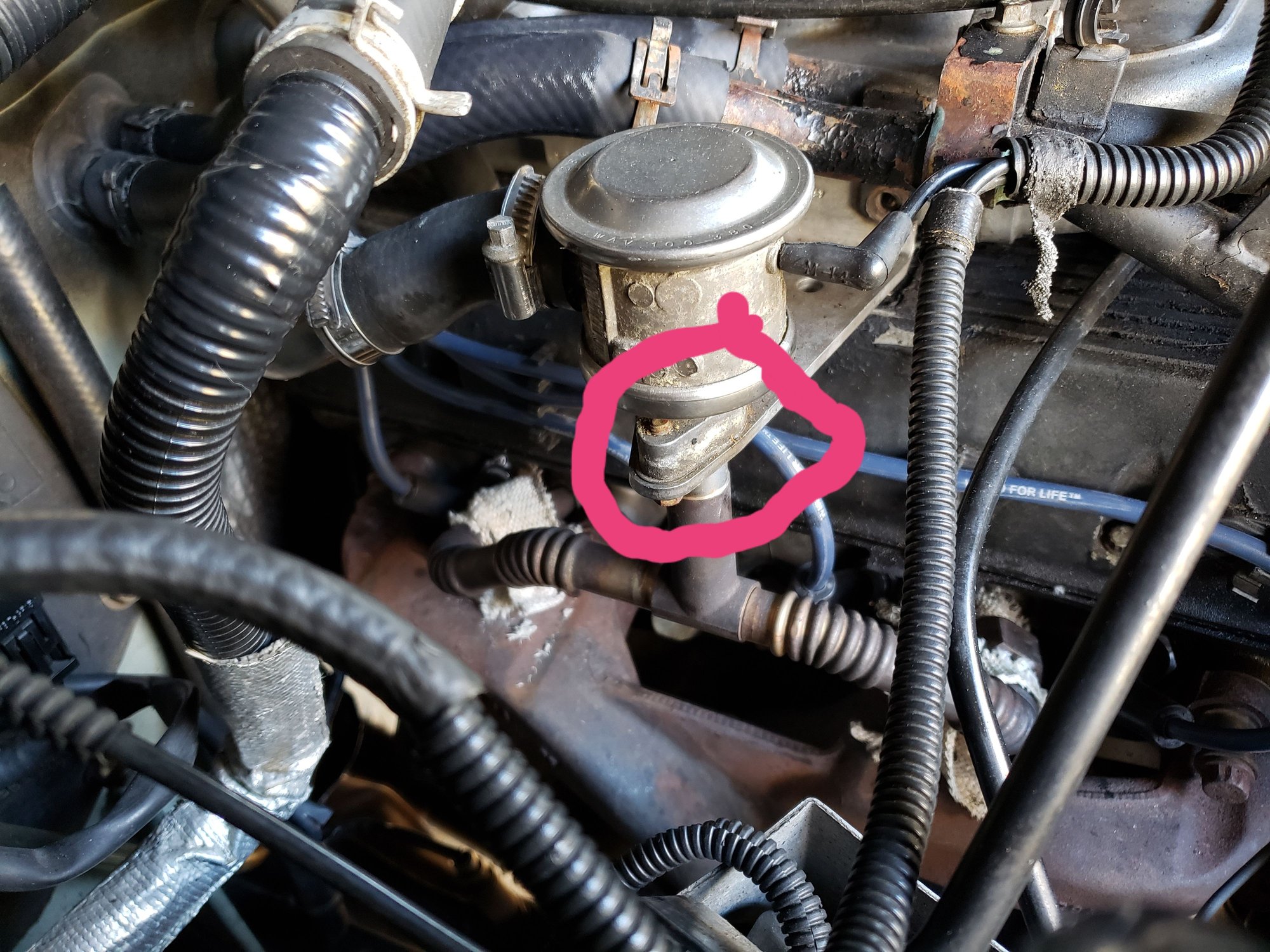

So I pulled the intake to change the coil and plugs out. I re-used the gasket since its metal. I'm still getting a misfire in #8 and #2 and now I see water coming from the Secondary air pump in the picture. I ran the engine for only a few minutes and water was spilling out the bottom of it.
How can water get into these pipes??

8&2 simultaneously indicates a bad ignition coil. Swap them left to right and see if the codes move. Which hose is the water coming out of? sketch on the photo with a highlighter.

yeah I'm also curious to know the exact SAI hose he's referring to.

Water was coming from the base of this pump. I ran it again today and didn't see any water this time.

That SAI device is a vacuum valve, the only way there would be water there and it is HIGHLY unlikely is if there was coolant in the exhaust. If there was your tailpipe would be pouring coolant, you would have dead 02's on that side, and you would definitely have a blown HG on that side. Even if all that was true, I cannot imagine how there woudl be water there as it is uphill from everything and the water would have to be pumped or blown to that location.

Also, I haven't seen any water coming from that spot the last time I ran it. May have just been condensation from the very moist atmosphere we have had the past few weeks.
