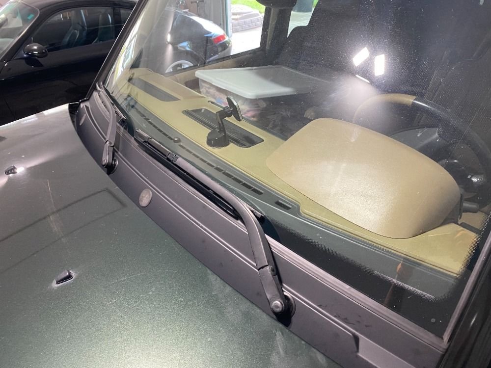

New to me 1999 Disco. Replaced windshield cowling. No sunroofs. Checked air conditioner condensation tubes. Suspension garage did me a favor and put ‘fire hose’ on her and said B pillars leaking on front door sides. Looking for guidance on 1) getting B pillar interior trim off. Don’t want to reef on them and bust them 2) any advice on taking off and replacing the seals. I’ve seen a few Youtube videos that say to buy LR authentic parts. Any videos out there on the process? I can’t find any but new to this adventure. Thanks much.
Here's the new windscreen cowling.

Are you sure it is the B and not the A pillars? The cowl replacement sounds like the A pillar. I have not heard of B pillars leaking. Its likely the seal between the roof and the body, the "caulk" they put in there cracks and leaks. If you pull down the rubber gasket that seals the windshield you should be able to fill that in with silicon. You dont need to remove the exterior A Pretty common fix. Thats my guess given no photos.
