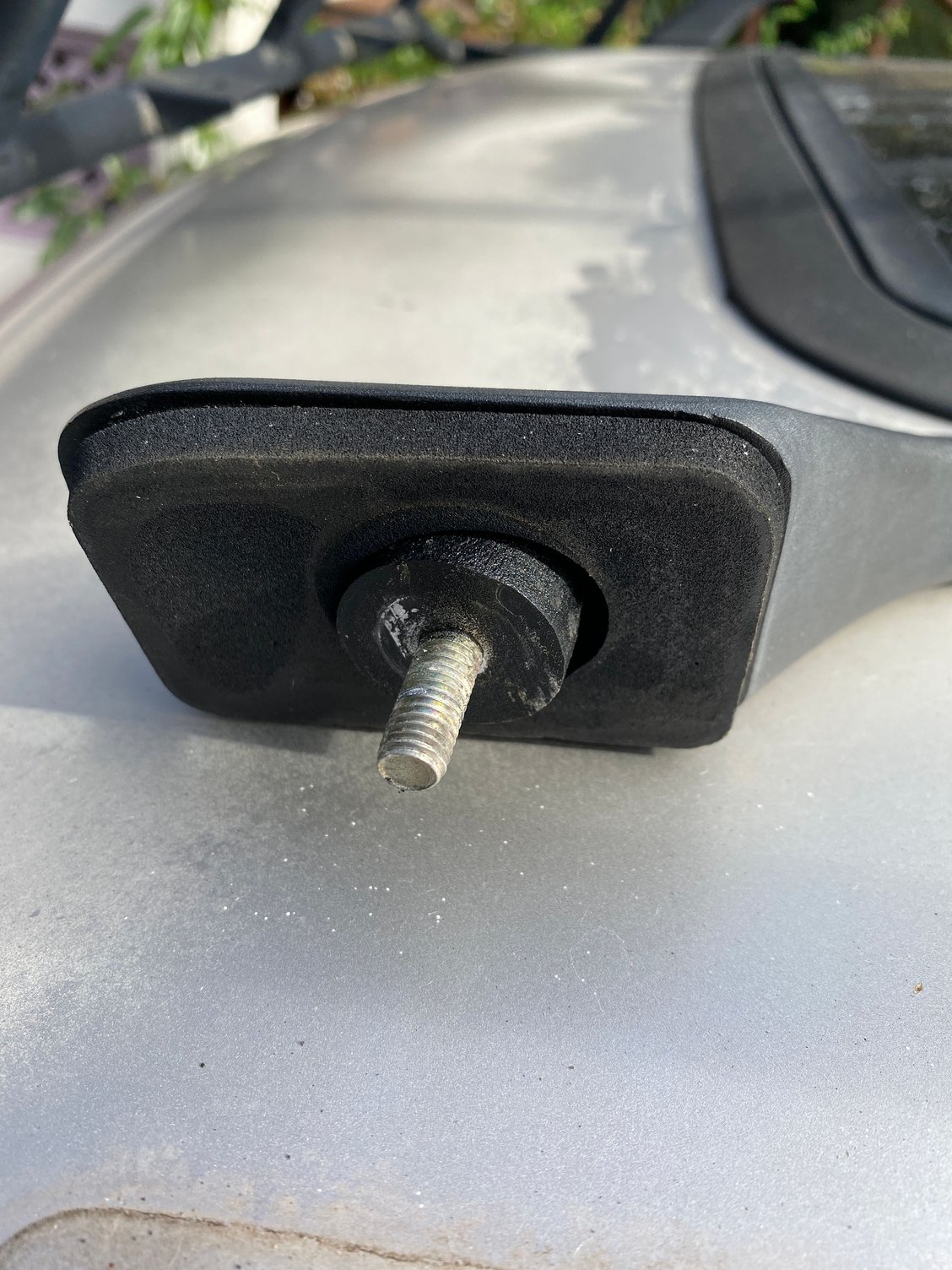

Roof rails ... where they mount -- those are the 2 racks that go longitudinally on top of the car. The horizontal bars on top. They mount to the car with one nut underneath, and have foam seals where they join the car.
The problem is, these foam seals absorb water after 20-25 years. And they start dripping inside the headliner between the double roof construction .

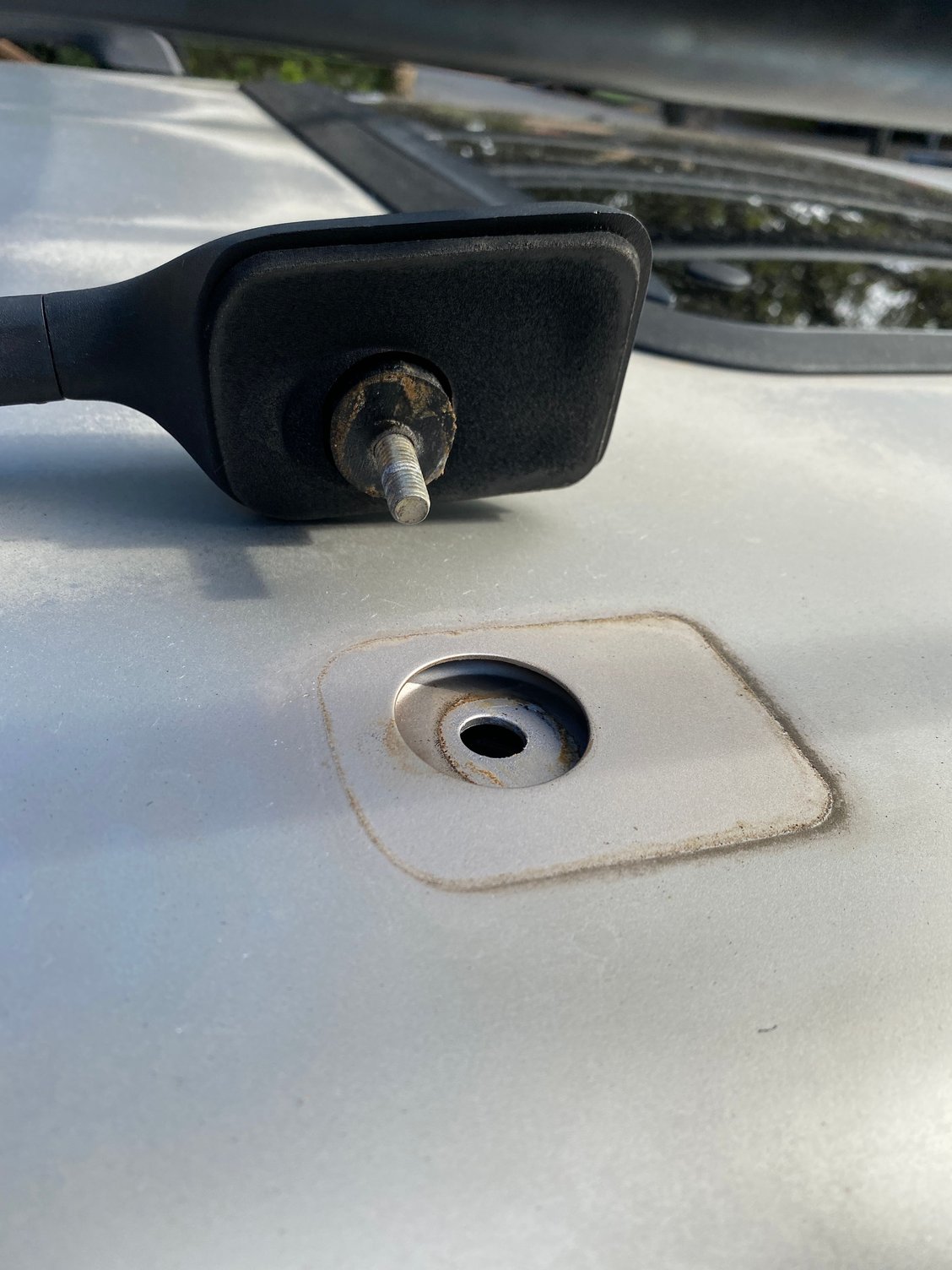

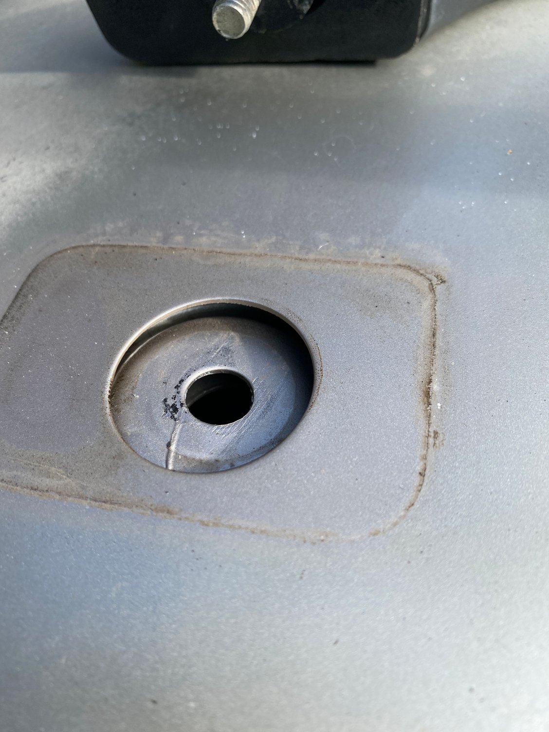

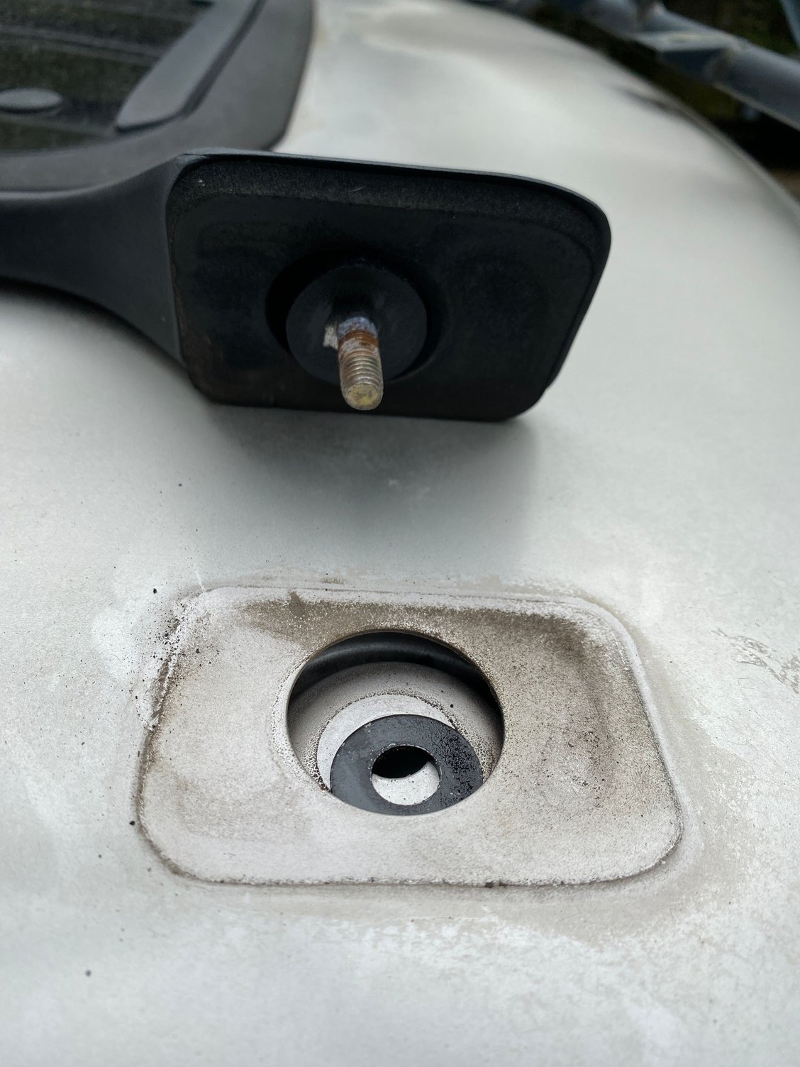

Not sure if this will help but here’s an instagram post I made about fixing my roof rail seals years ago
View this post on Instagram
What it does show are the 2 layers of roof skin. Water seeps through the foam seal (tightening does no good) -- gets between the outer layer of roof, and inner layer of roof, and runs right down to the b-pillar from that back roof rail mount. It never gets the headliner wet, as you can see, the inner hole is smaller than the outer hole, so it stays between the two roof shells.
I just put a little bead of black sikaflex around the outer large hole on the roof top, not enough that it would ooze out. (but be at the ready with a rag and alcohol or whatever to mop up what will inevitably squeeze out). And for this truck, I re-used the original foam seal because new is no longer available.
Note: put those black spacer washers back. Exactly where you found them. Some have them, some do not.
