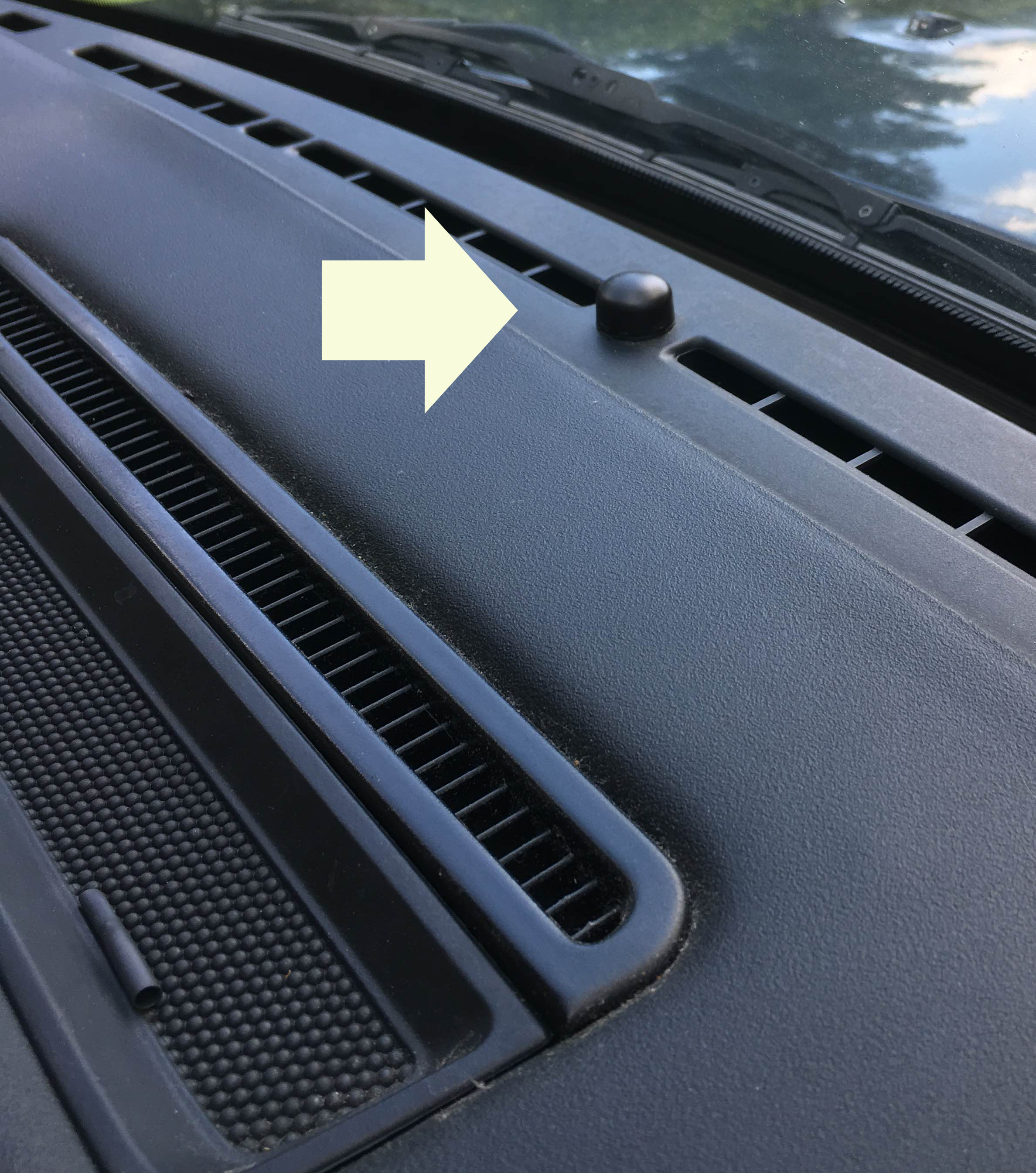

The part the arrow is pointing at.

It is part of the alarm system.

It's the little rubber tray you can put stuff in.
Oh, an alarm bit.

In addition to the alarm bit, it is a starting point for the dreaded dash curl

Sorry to be the one who knows that it's the Sunlight Sensor and part of the AC system.

Joe- I stand corrected, NUMBER 9 is right, it is the sun light sensor:
Sunlight sensor
The sunlight sensor consists of two diodes that provide the ATC ECU with inputs of light intensity, one as sensed
coming from the left of the vehicle and one as sensed coming from the right. The inputs are used as a measure of the
solar heating effect on vehicle occupants. The sensor is installed in the centre of the fascia upper surface.
(from the RAVE).
Always willing to admit my mistakes, especially when it comes to Rovers.

Yep part of HVAC system.
