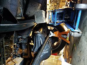

Fan wrench is not needed, the nut is wide enough that an adjustable wrench will fit.
Front crossmember does not need to be removed to get oil pan out. Just jack up frame, let suspension sag fully, support with jackstands (or risk truck crushing you), spin pan around backwards, and pull it down and out towards the driver side.
Crossmember bolts are apparently common to sieze
(mine are).
See pic, oil pan off, crossmember still on.
Attached Thumbnails What did you do with your DII today?-20170805_204958.jpg

^^^^Do you have the jackstand under the tie rod bar?^^^^
If so, not good...if the weight of the vehicle was to suddenly drop on that setup...it would pop the socket part of the joint right off the stud/ball. Or bent the living daylights out of your tie rod bar...while the rest of the vehicle rest squarely on the ground...or you.
Steering linkages are not good safety support areas, frame or axles are normally your best bets.
Brian.
Brian.
Lol, no, it's not.
Look closely, you can see light between them.
I pushed it forward while I jacked it back up.
When I let it down, that's just where it was when I took the picture.
I had the jackstand under the I beam.

You can give an old guy a heart attack taking pictures like that...lol.

At the back of the I beam, and under the frame.
I had 4 jackstands under there.
And the jack barely touching the frame.
You can also see in the picture that nothing is supported, as the block of wood is crooked.
