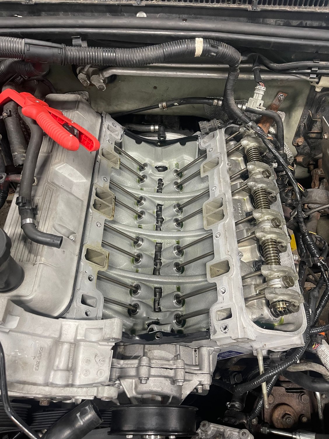

Originally Posted by Zinhead
In probably a stupid financial move, I ordered a Turner short block and it came in last week. New motor mounts are going in, but any suggestions on work that should be done while the engine is out?
Old Jul 31, 2021 | 10:53 AM
  #25
Zinhead's Avatar
Joined: Nov 2020
Posts: 21
Likes: 30
It took longer than expected to put it together, but the vehicle is up and running again with a bunch of new parts. I will post updates here from time to time on how the new Turner short block is holding up. Thanks for everyone's help with this.

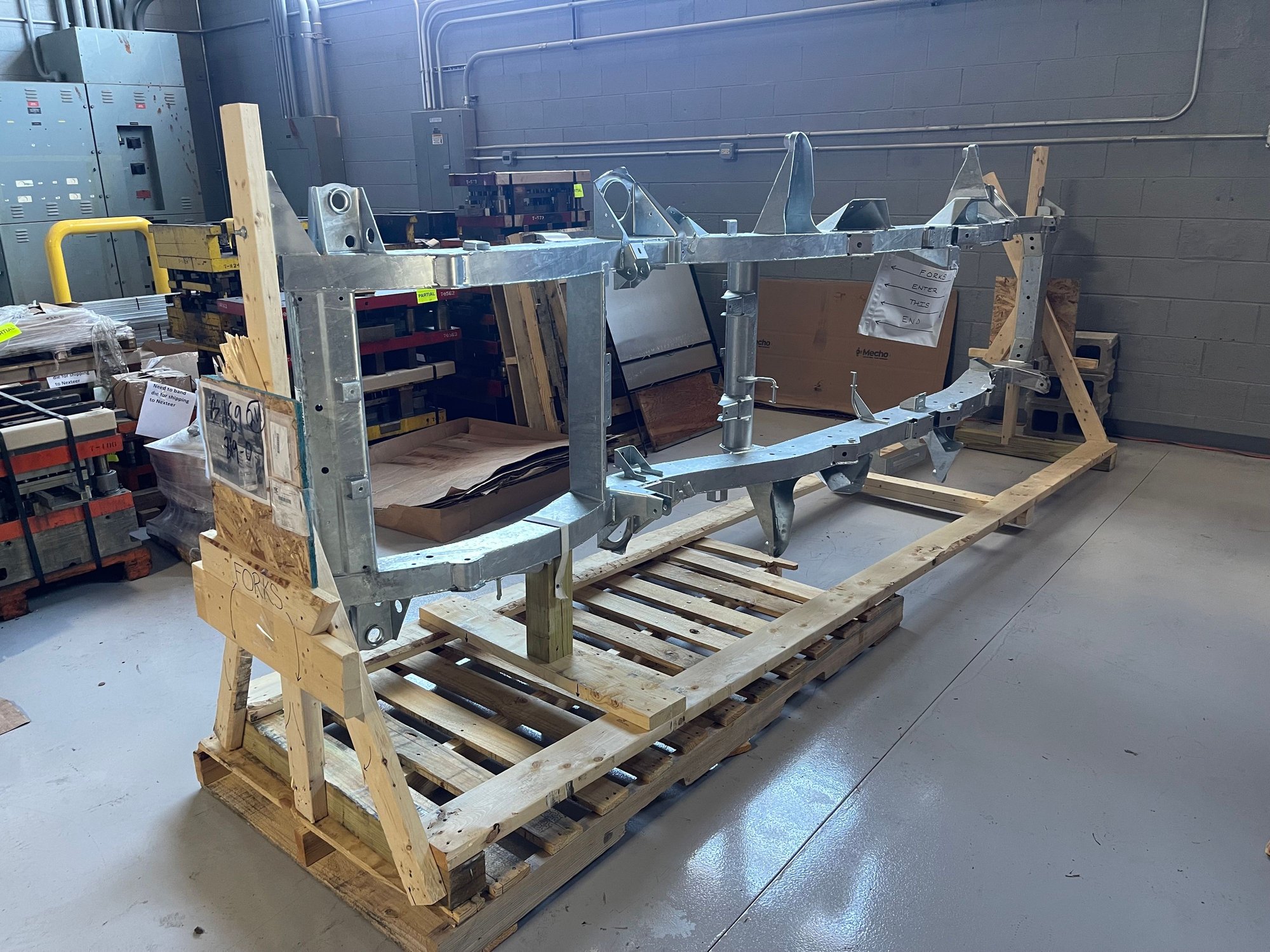

Old Dec 28, 2022 | 04:54 PM
  #30
Zinhead's Avatar
Joined: Nov 2020
Posts: 21
Likes: 30
Phase II - The question is to keep it galvanized or paint it black?
