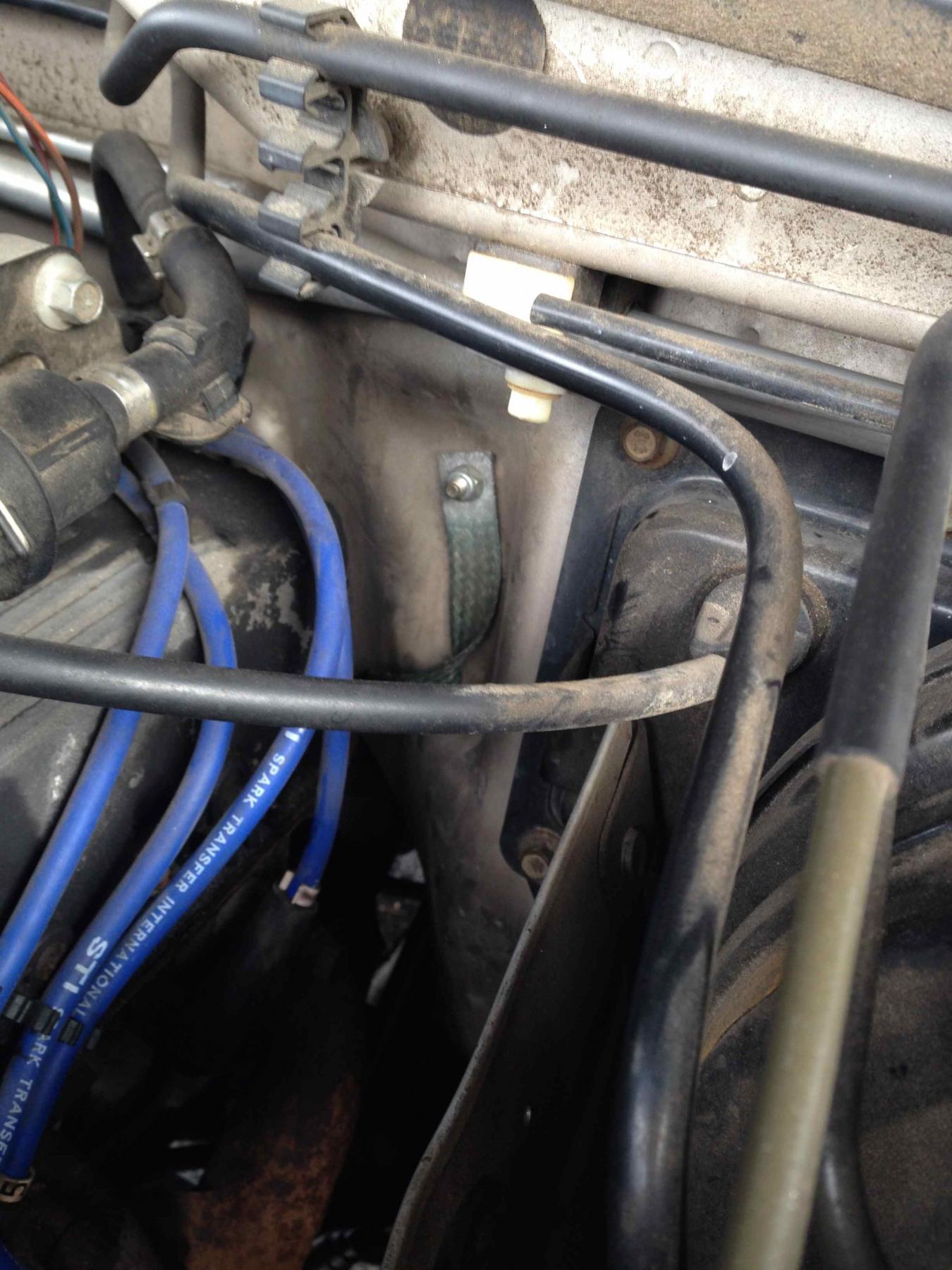

Check the ground strap behind drivers side head, head to firewall. This caused my code a palooza.
Also, I have been in contact with 2 discos with re occurring O2 codes, even after replacing sensors.
In both cases the pins on the ECU were bad. I suck at electrical, but was explained that you check with a multi meter... for what and how is your burden.

I'm going to be honest here....I don't think I even have that strap. Keeping in mind, when I bought this car, it had been striped down to the top of the block, and all the parts were in the trunk. It all went back together all right, but I do not recall this grounding strap.
Anyone have some pictures for reference?

I was told that the system can find grounds at different points, one being the e brake cable.
Add the ground strap and it should fix it.

Here is a pic I found online. You should see a stud on the firewall.
Attached Thumbnails What the heck happened.....so many codes...-lr-ground-strap.jpg

I'm 95% sure I don't have that.
I think I even know exactly what bolt it goes to as I have always wondered what went there.
Wondering where it bolts to the head....and I can imagine I can get a general grounding strap at any local auto parts store.

The head has 4 threaded holes at the back. Top inside hole should have the wiring harness strap bolted in, Bottom inside has a forked bracket that the harness runs though.
Now you have two more towards the outside, top one usually has the strap.
Im sure any heavy gauge cable would work, its only like 6" long. Welding cable is best as it has the finest/most strands.
OEM should be available.

Now I'm wondering how many thing are/aren't grounded right...
I had to puzzle piece my engine back together with the Rave, and wondering what's missing. Things like worn out and frayed grounding strips were prolly thrown away by the prior owner and I didn't have them on hand for the rebuild.
I'm going to have to take a close look at my engine bay and see if the grounds mentioned are even there.

I'm sure Roversnorth has it. I think the only other ground there is, is attached to the Alternator bracket, which I'm pretty sure you have or I don't think your rig would work.
