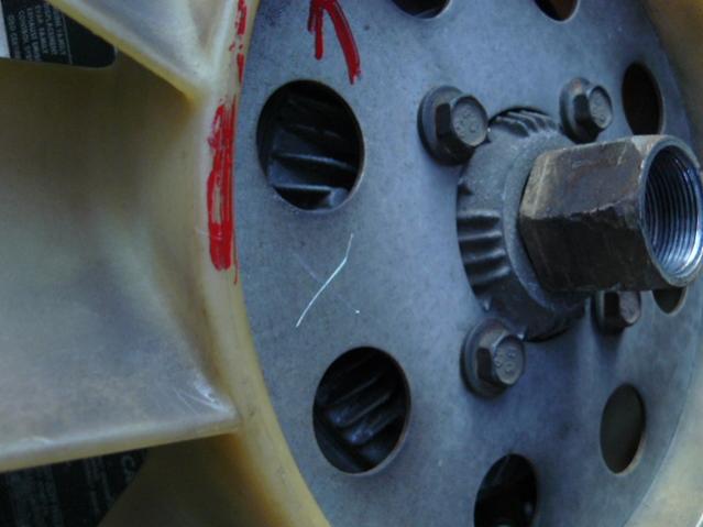

Here's pix of what I did with Chevy clutch and chevy fan. It does move more air than stock D1. All junkyeards may not have a Rover, but most have a Chevy...

Buy a used fan, usually comes with a clutch, try it, if it doesn't cool well enough the buy a chevy clutch.
What ever you do though, never cot blade on a plastic fan to make it fit. Doing this can cause small cracks to fail in the plastic and there goes the fan, Sorry Buzz, that idea scares me.

And Mike is correect, you should machine cut anything, inspect for cracks, etc. I found they had two types of fans, one all nylon with a nylon hub (black plastic, like a radiator tank), and the white nylon with metal hub. Will re-visit my handiwork per Mike, and it was intended as an experiment for showing what could be done when factory parts are not readily available. Antichrist had good info on a metal fan, which also needed minmal machining. The deeper fans do move more air, mine went from like 800 feet per minute to 1300+. Of course, still doesn't matter at 60 mph, where it is 5280 feet per minute of air speed.

Auto parts store should have clutch in stock for Chevy 2000 van, 4.3 liter Without AC. The with AC model is a seven inch clutch and does not fit very well. You could replace clutch while you await correct fan, but... your fan might fail if clutch actually worked, as it would be handling more power from increased coupling.
