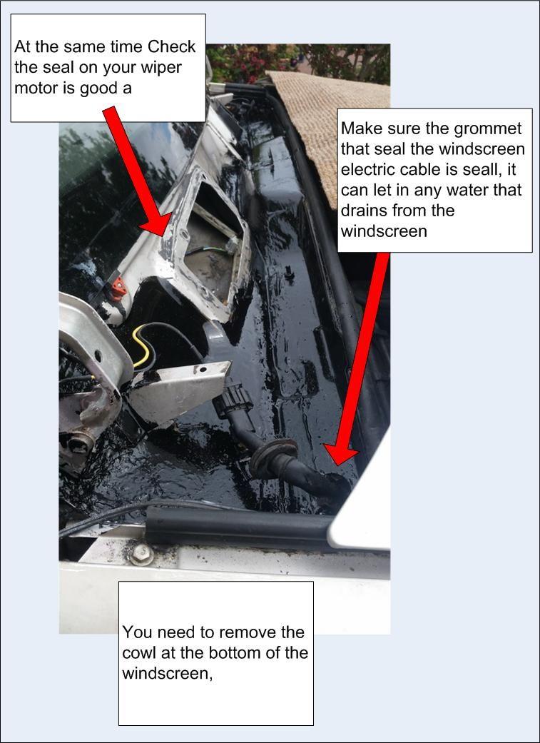

Are you sure its the A pillor, as having had alot of water in mine, I found it was not A pillor, but a rust hole under the bottom of the screen, but as I was fixing that, I found that most of the water was getting in passed the grommet that is on the heated screen cables an there is one ob each side,

Hi Andy, not sure what bit your talking about, if it the wiper seal, as mine was rusty it had blow a gap in the seal surface so I used a 1 inch paint scraper to getly remove the rest
