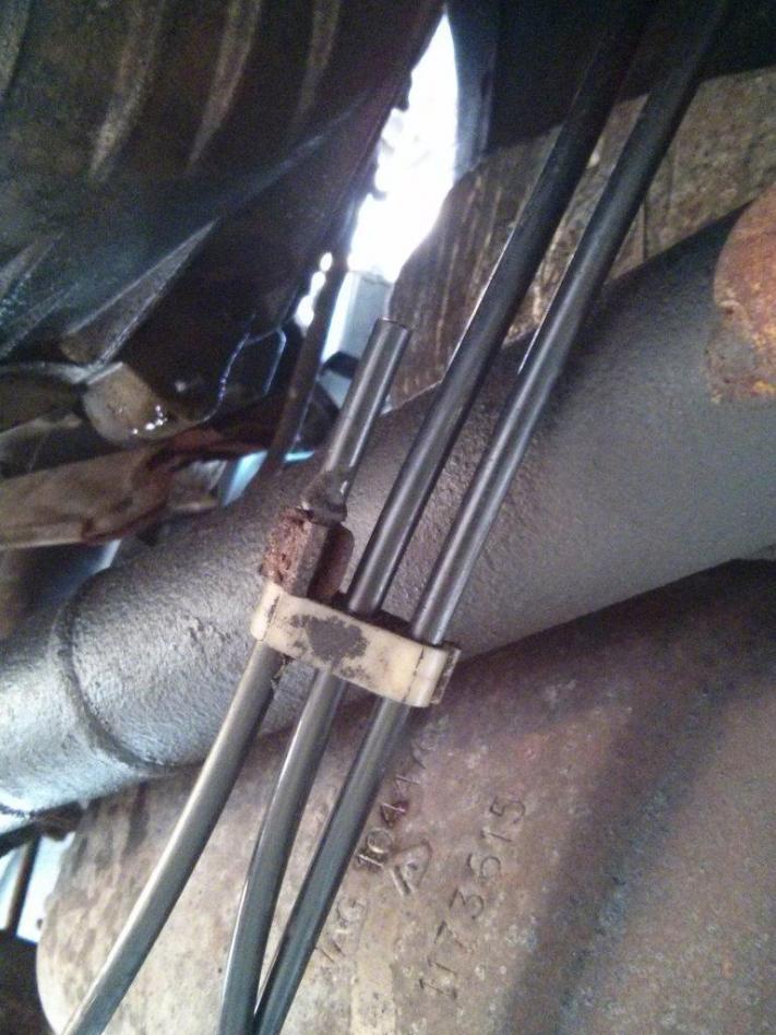

Ok got under the truck yesterday found three lines. Two seem to be vent lines maybe the transfer case? I spiced into them and ran them back up the firewall think I found a plastic clip that they belong in on the firewall near the heater core. Now the question is what's the deal with the third? it comes down under the truck with the other two hits a plastic retaining clip(photo) then just stops. Can anyone point me to a diagram etc that might provide some insight. The metal clip on the third line seems to be there to hold it against a thin piece of metal or plastic.
Thanks

Don't worry about the tubes and don't worry about adding extensions to the tubes unless you plan on going thru water 3' or deeper.
Have you had your codes read, if so, what are the actual fault code numbers?
