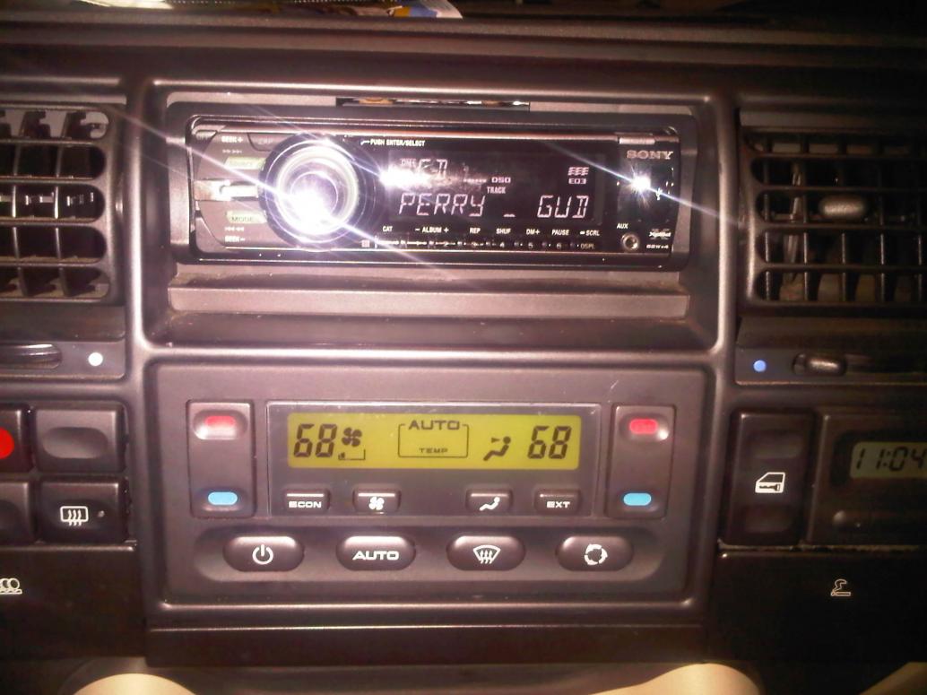

finally, its in and controlled by the steering wheel! love the green.
certainly not hi-end sound, but better than the factory radio and, most importantly, i can control it with the ipod or usb.
last night my brother-in-law was like "duh, most factory amps take high-level inputs while after-market amps take low-level inputs" know-it-all.
a couple pics to end the saga...thanks much Chris.
