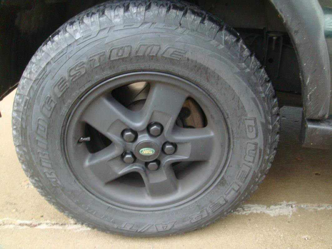

Default DynaBeads work well --- Off topic kinda
I have these Dyna Beads on all 4 of of my tires + spare and they do work well. There is not a lead weight on any of my rims. I like them and they seem to work well. I opted for these over the drop in powder that Expedition Exchage sells. Since that is sensitive to moisture and I thought it would not work well. I have Bridgstone Dueler AT /Revo 2's 245/70/16 on matte black powder coated 16" LR Typhoon rims. I have had this setup now for about 10,000 miles. Everything is smoother coming from the 18" rims and highway tires.
I do feel a slight vibration around 35mph when the centripetal force spins up the beads(yes I took Physics) to the outer wall of the tires. Its very slight, and does not bother me. Supposedly they are ceramic beads, if you get new tires they are worth the $50 extra. Stand there and watch your tire installer pour the bag in while he mounts the tire as I did. Ask him not to go crazy with the lube stretch the tire over the rim wall...as it can make the beads stick together. I tipped him well for being annoying.
