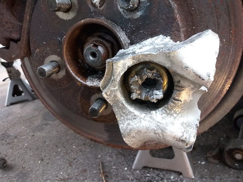

One of my lugs was so welded to the stud that it caused the entire stud to rotate in the hub, meaning that I couldn't loosen the nut at all. I ended up having to cut the wheel off with a grinder, sawzall, and various chisels. Would have been completely impossible on the side of the road.

WOW! Holy
