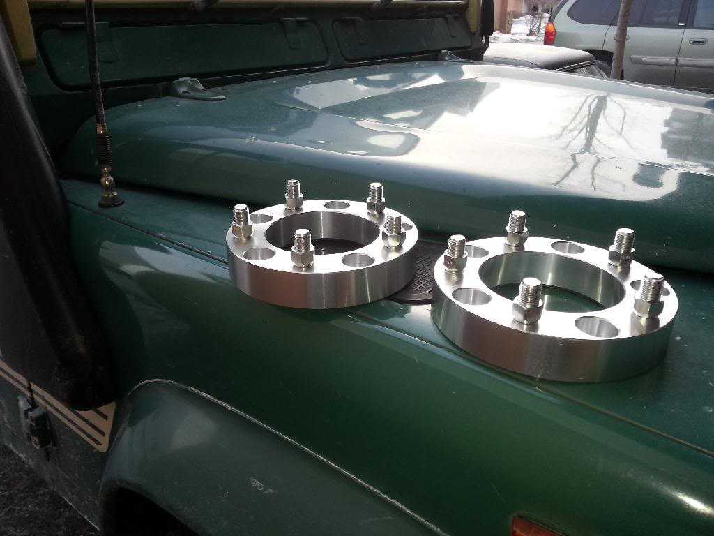

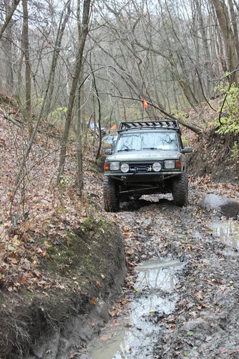

I'm running 1.5" spacers

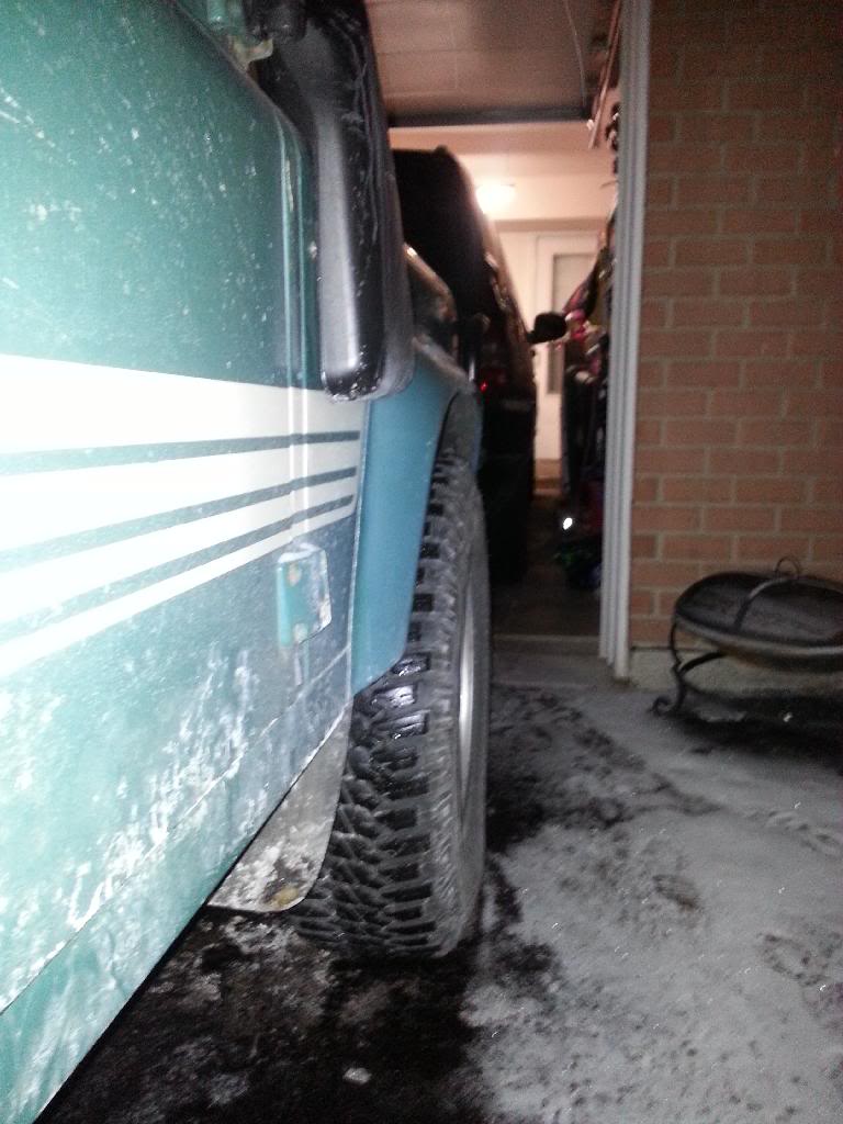

I run the same ones Bill does. 1.5" spacers from EZ Accessory. Got them used for dirt cheap, about $50 for all 4.
I understand the "more stress/leverage" argument but the fact is they don't put any more stress on the bearings than running offset aftermarket wheels. How many Jeepers and Rovers run aftermarket steel wheel with more offset? A ton. And there isn't an epidemic of premature wheel bearing failures. Yes physics supports the fact that spacers add stress but that increase just doesn't translate into real world failures.
I don't have a ton of pics of my truck straight on but here's one.
And the 315/75/16's still stuff.

It's also nice that my rims sit flat like they are supposed to instead of on the bolt heads and a bit crooked.
Nice space savers you're running there Brett
