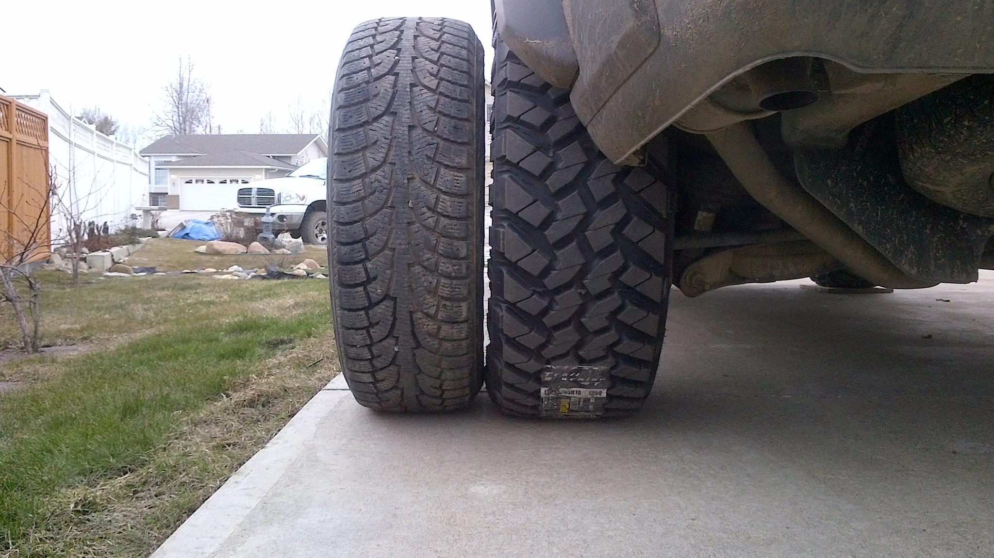

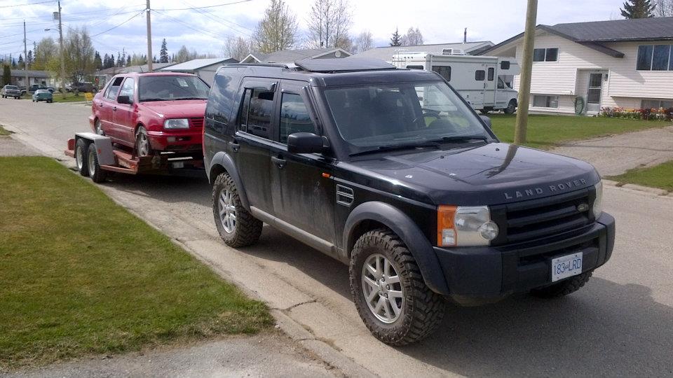

I have installed what I would call the largest tire that anyone should install.
I run 285 65 R18 Nitto Trail Grapplers

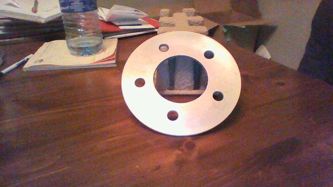

They have an aggressive lide lug, and this lead to the tire rubbing on th upper control arms in the front, requiring spacers. I used the flat plate style spacers and found that I did lose hub centre and experienced vibration, lug nut loosening, and so on. The tire measures 32.69 inches when new (advertised as a 33"). AND they rubbed EVERYWHERE! The tire is too large for the wheelwell, even with the Johnson Rod lift.
Most people on this sire will recommend that you buy the electronic tools to change the settings in the computer to establish your lift. And a 32 inch tire is the maximum recommended tire size.
I'm not sure if spacing the tire will affect the turning radius, or cause the tire to rub while in full steering, but experimenting will cost you money - I CAN GUARANTEE THAT.
I can answer any questions you may have to the best of my ability. I have attached some photos, for reference.
