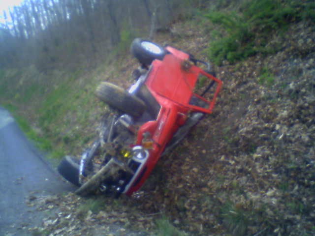

BTW, I no longer have the 'Cuda or the Land Cruiser.
I sold the FJ to my brother-in-law 18 months ago.
Sadly, the weekendbefore I bought the LR, he rolled it over in a ditch.
http://www.bipolardave.com/images/fj404.jpg
Old May 1, 2008 | 10:11 PM
brooksa's Avatar
Joined: Dec 2007
Posts: 356
From: Gainesville, GA
Default RE: When does the pain stop?
That sucks, looks like that hurt
