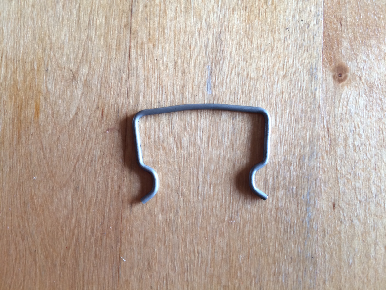

This came off one of my coil pack harness. It's a retainer clip. My other one popped off and did a houdini.

Send me your address via Email and I will throw one in an envelope.

I've lost so many of those I just quit putting them on. My coils have not had them for a couple of years and I haven't had any issues, but I know that doesn't answer your question...
I made some from jumbo paperclips and they worked as well as the originals.

I used to lose those clips also until I realized that they aren't supposed to be removed to get the connector on and off. You press the clip down in the center and the sides will expand outward so you can remove/install the connector.

I was waiting for someone to comment on that. I parted out 2 rovers before I realized that.
