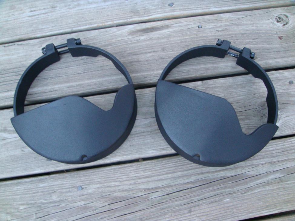

Well guys I bought these on eBay and am having my welder buddy add 1/2" on both sides to make the circumference 27.5 inches. Which is what the measurment is on a DII. Then they will clamp on the front ring of my front Diff. But as you can see the rear diff is not protected at all. And the front Diff is only protected from the face not from underneath. Later this year I am moving to Sedona AZ and will be doing some trails around there that are 90% rock. Just want to have my armor in place.
I have sprayed them with Rusoilium truck bed liner and they look nice. But now thinking about it. They will only work on the front. The rear diff faces the opposite way and does not need protection from the back which would be goofy!
http://cgi.ebay.com/ebaymotors/ws/eB...K%3AMEWNX%3AIT
I know KMC ACM or one of this makes a bolt in place galvanized rear guard. Think it is really ugly though. Has anyone come across another this a bolt on at a decent price? I dont want to weld anthing on
