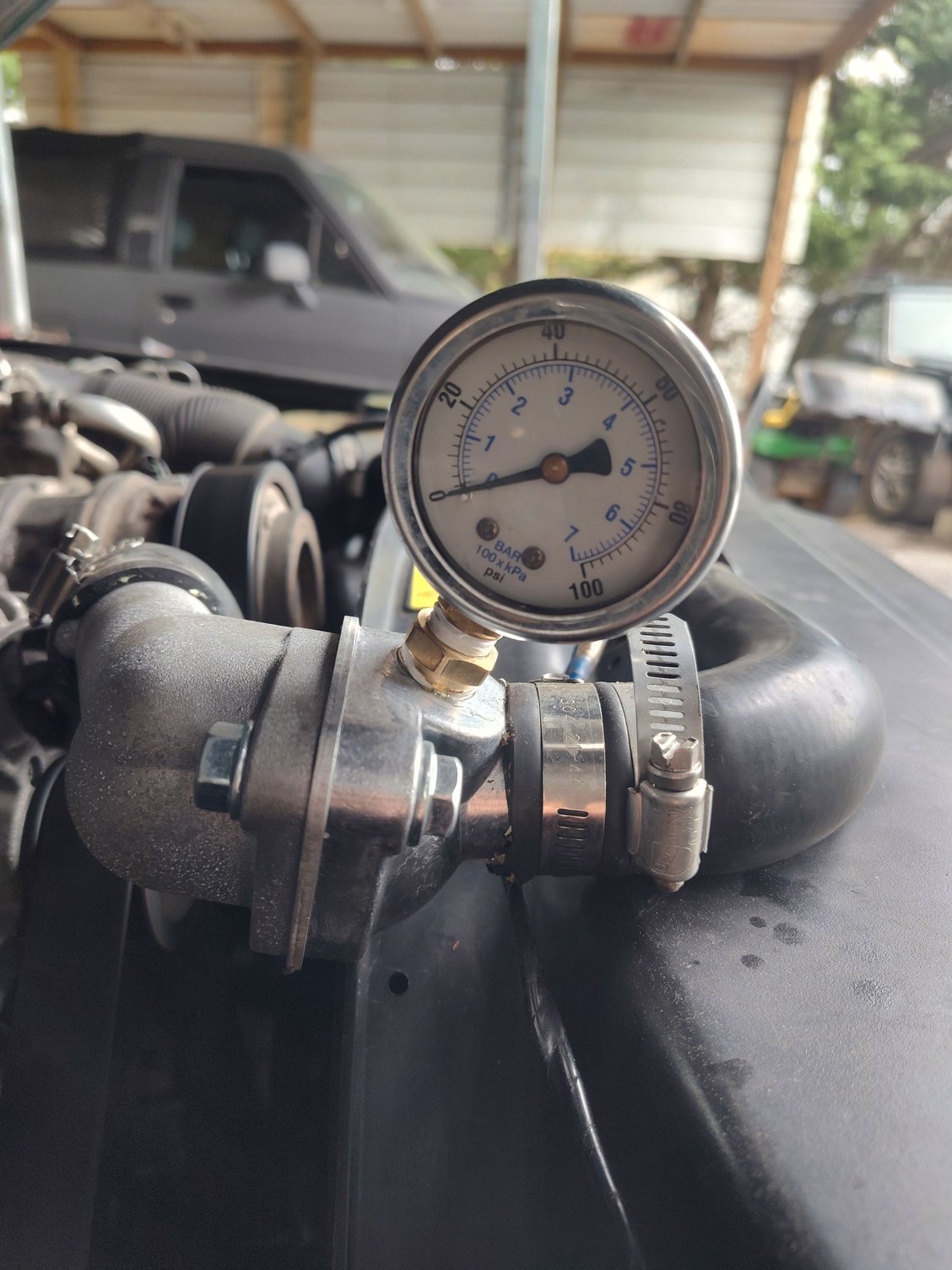

Just got kicks I decided to do a leak down test on the 25x,xxx mile 99 4.0 block I just stuffed with 4.6 internals. All new bearings, 4.6 cam, inline thermostat mod.
Passed the leak down test with flying colors. Figured since there was a 3/8 port on this why not give it a go. I don't register any pressure. This is obviously post thermostat and it's not open yet but I should still get excess pressure since there is the bleeder valve.
Will continue to keep an eye on it. Unfortunately it sits too high to close the hood for an at speed test. Reads zero until about 5 psi. She's not budged from zero.

Normally they don't build pressure till been hot and running long enough that the thermal expansion builds the pressure.

If today wasn't the first rainy day we've had in over a week if I'd have taken the good off and ran it down the road. With the thermostat mod, 4 or 5 year old OEM radiator and an O'Riley's water pump it's hard to get this thing to budge above 180 on a 70 degree day.
I have an extra oil pressure gauge at the shop with electric pickup. I can perhaps TEE this into the the ridged line coming it of the top of the coolant overflow. I can then run a pressure test after a long run.
