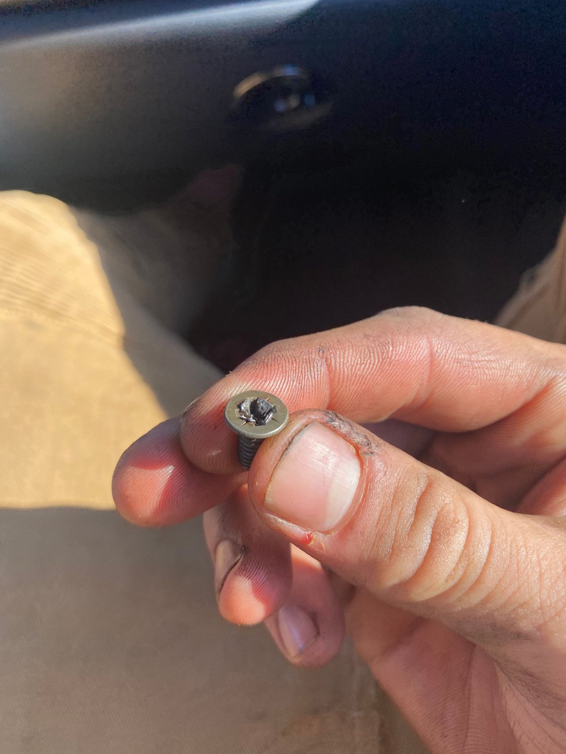

Hey gang,
I am in a pinch. I am a total doofus and knew this happens…. I am in my 04’ front cover inspecting the oil pump and doing the timing chain. Tried to hand remove the first oil pump pozi screw, lo and behold with little effort I stripped it in a minor fashion. I used my hand impact on immediately after.
i dont want to put it back so I am going to the LR dealership hoping they have this screw. However, they wont do anything without the part number.
does anyone know this screw part number?
UPDATE: I was told to go to the hardware store… wonderful service.

Thanks man, I really appreciate it. I was able to get that screw to tighten… but it may never come out again without some drilling.
