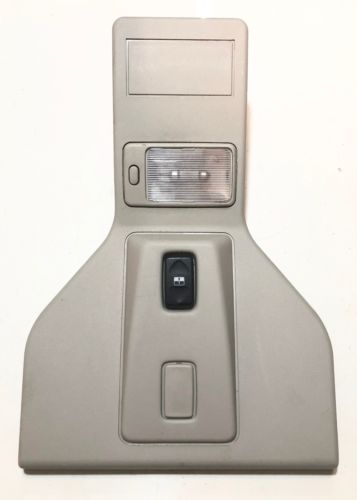

Hello Paul,
Are the corresponding rear roof consoles for electric sunroofs also interchangeable (partnumber EHI100030LUM from D2 with partnumber BTR4543LUM from D 2) ?
I’m very interested.
Console from Disco 300 Tdi (will be replaced bij console for electric sunroof)
Console from D2 ; will this fit in my D1 300 Tdi ?
Greetings,
PierroDisco from Belgium
Old Aug 22, 2022 | 03:02 PM
nashvegas's Avatar
Joined: Oct 2007
Posts: 2,794
Likes: 2,001
From: Whidbey Island, PNW
Yes, 100% the rear and sunroofs all fit and interchange between D1 and D2. Front and rear are the same. D1 and D2 are the same.
I don't know if that piece of plastic will interchange though, I recall that center portion where the switch is actually doesn't pop out, it's made together with the rest of it.
