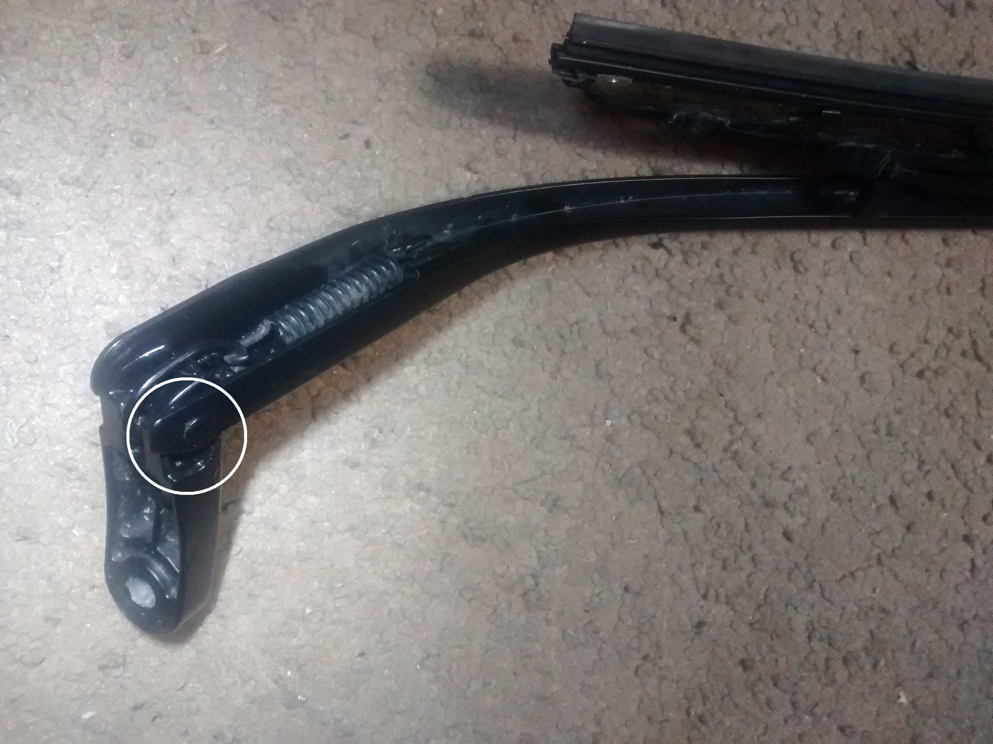

alaskan_disco2_girl:
You might try lubing the pivot points near the attach point of your rear wiper arm. See picture.
I just did the D1 front wiper upgrade this evening, I did the upgrade because the drivers side wiper was not making good contact with the windshield and I broke the plastic locking piece trying to clean the ice off of it.
I brought the old D2 wiper arms in and checked them. The joint near the attach point that allows the wiper arm to swing away from the windshield was very stiff, I lubed it and worked it a little bit and it freed up. I'm quite sure it would have made a good bit of difference to the pressure of the blade on the windshield, the spring wasn't strong enough to overcome the friction in the dry pivot point.
Use a lube that won't congeal in the cold. I would suggest Tri-flow. Lube both sides, obviously. Try to get lube into the pin area and on the bearing surface, work it until it's good and free, and you can feel good spring tension.

Nowhere close to the interior, thank god. Glad I don't have to deal with those extreme temps.
I had a fine time with the front wiper D1 mod. It is the back still giving me issues and a motor problem at this point. I bought a motor off Ebay. No, your diagram is actually not where my arm snapped off. It snapped off right near the base, where it bolts on - when I gently wiggled the arm, it snapped. On the pivot/rotation point this shouldn't happen when moving side to side. I did lube it up very well when installed. Made sure to not over tighten.
