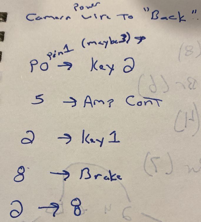

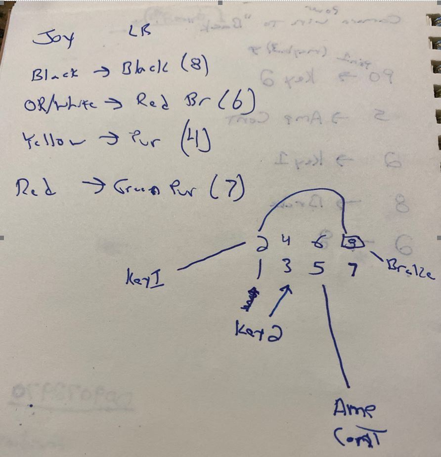

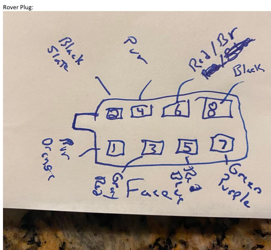

Just finished my wiring harness for my Joying (Android) radio and thought I'd share. I was able to have the steering wheel controls work as well. Hope this is helpful to people: It is good to know that NO mods are needed to your vehicle wiring. Buy this for extra parts/wire. You can eject the wire from the block by poking them out from the pin (non wire side)
Amazon.com: Metra 70-1784 Radio Wiring Harness for Audi 88-99/Volkswagen 80-Up: Car Electronics Amazon.com: Metra 70-1784 Radio Wiring Harness for Audi 88-99/Volkswagen 80-Up: Car Electronics
Harness tape:
Automotive Wiring Harness Cloth Tape, High Temp Wire Harness Wrapping Tape, Black Adhesive Fabric Tape, Noise Damping Heat Proof (19MM × 25M)(2 Rolls): Amazon.com: Industrial & Scientific Automotive Wiring Harness Cloth Tape, High Temp Wire Harness Wrapping Tape, Black Adhesive Fabric Tape, Noise Damping Heat Proof (19MM × 25M)(2 Rolls): Amazon.com: Industrial & Scientific
I cut the black wire in 1/2
Then I spliced in Key1, Brake, and an extra wire to loop back into pin 2.
Next, key 2 wires into #3
Finally AMP CONT goes to 5
That’s it

How did you get the steering wheel controls working ?
Old Jul 6, 2021 | 04:50 PM
Chris Gregson's Avatar
Joined: Jul 2014
Posts: 11
Key1 and Key2 and this video in a way:
, but I was able to accomplish it all from the wiring harness. Enjoy, and I hope to save you tons of frustration and time, and hopefully have others get onboard with the nice rear view camera
