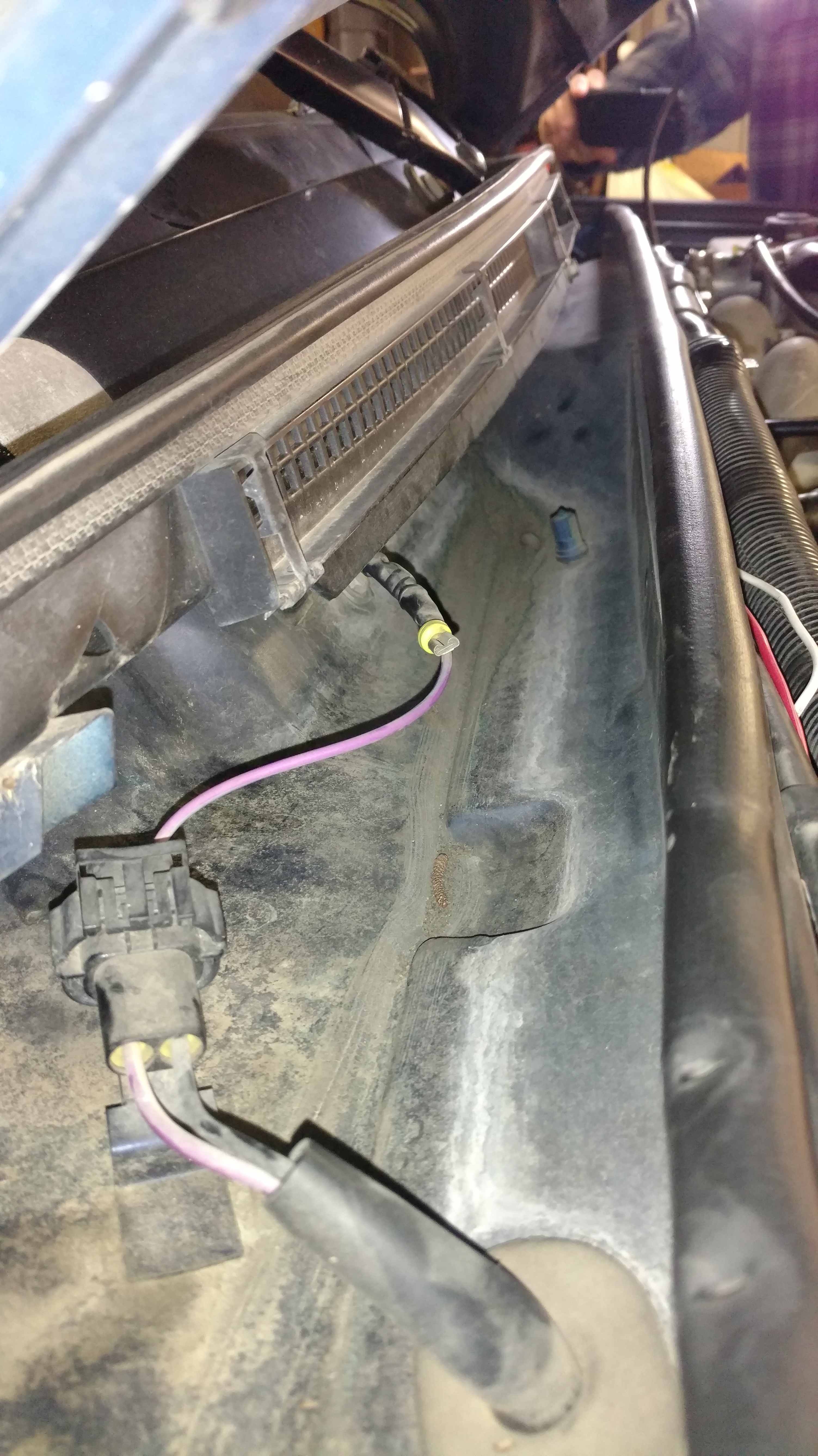

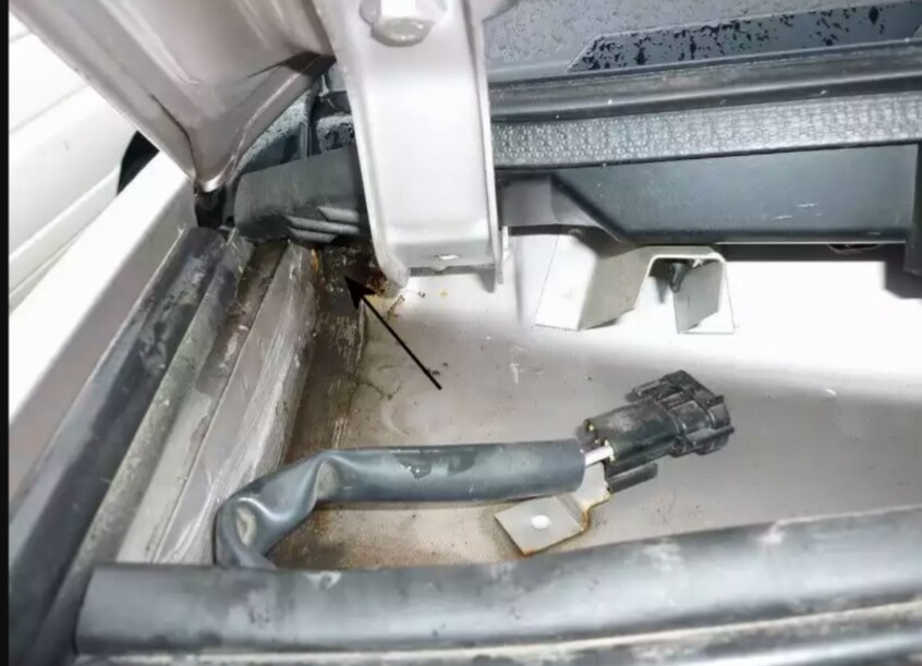

My son has a Disco 2 and we are just digging in. Can anyone tell me what this wiring harness is for? It is cut on both sides under the hood.It has black and purple wires

Heated Front Windscreen/Windshield

Yes, Screen heater multiplugs

Thank you...When looking at the windshield can you distinguish that you havery a heated windshield? I'm assuming ours was replaced.
You can see very tiny wires along the windshield vertically.

Look at the glass and if it's heated you will see the tiny wires in the glass. Like the rear defroster only way smaller. Something like this pattern...

Since I have the connectors I decided it would be fun to find out whether I could retrofit a heated windshield. Sure you can no problem. just add the cost of a Hawkeye to reprogram your BCU.
