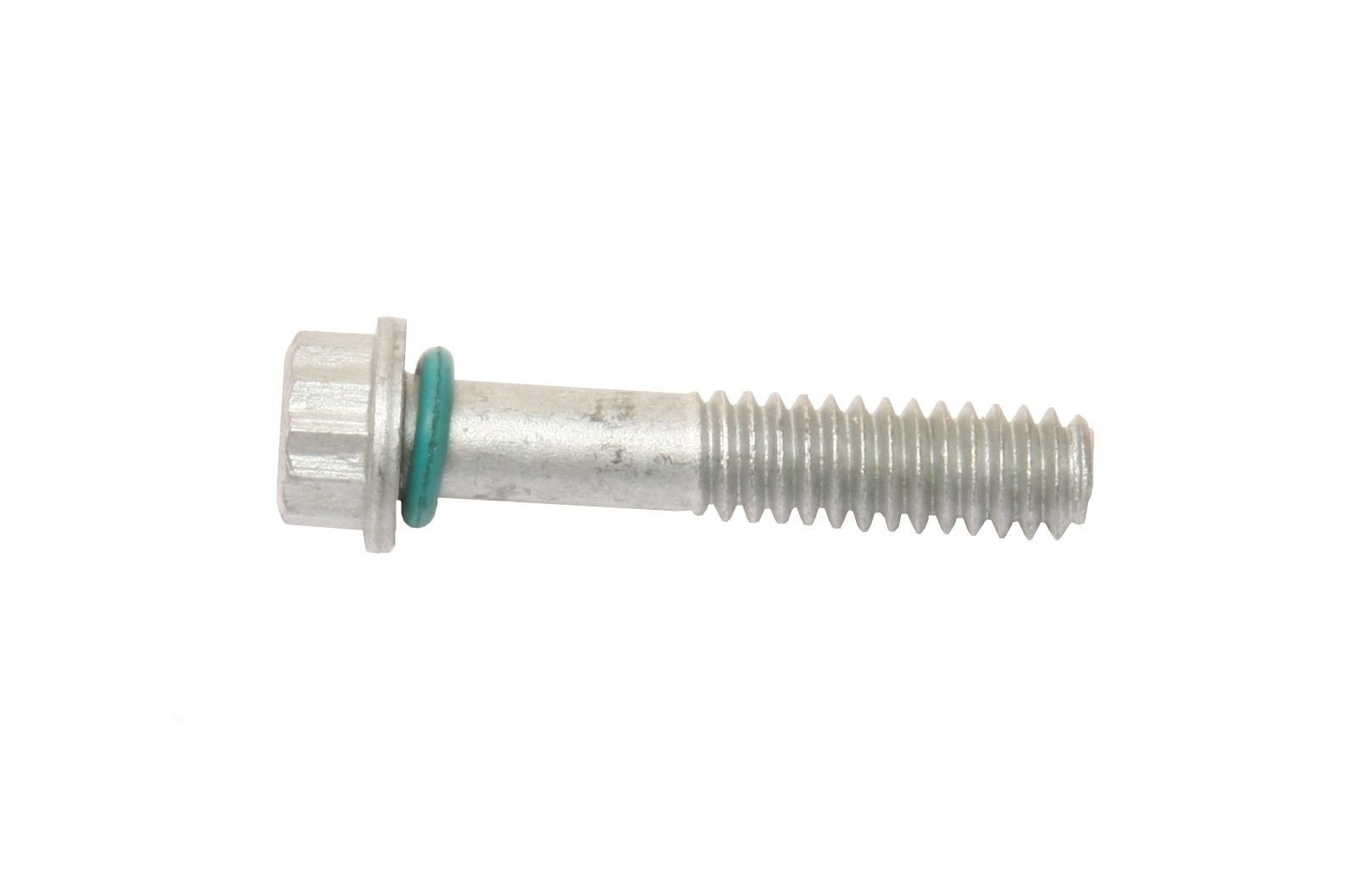

What is up with this? What is wrong with the originals; what is the alternative to $35 worth of bolts (RN)?

You can reuse the valve cover bolts however they have little seals around them to prevent oil leaks. You can use small o-rings as replacements like the URO come with. That's why the manual says to "replace" them.

Thank you!
