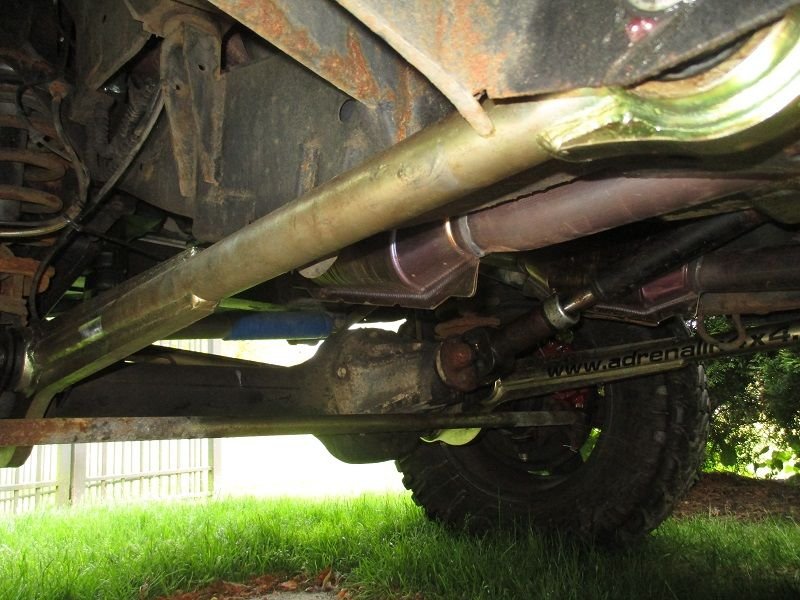

Old May 31, 2019 | 06:23 PM
  #40
XRAD's Avatar
Joined: Feb 2019
Posts: 1,288
Likes: 445
Thx for comments! Finally got a set of Adrenaline 4x4 front caster links 6 degrees(make sure to check the stamp on the end of the links for a '6'). Super easy to deal with this company via email, and had them to me in less than 2 weeks. The steering is probably as good as it will get now, on the road. Can do one finger turns, where before, it was a struggle to get back to center with oem links, and moderately better with 3 degree terrafirma links.. These went 'right in' without any issues(advert facing engine block). The OEM rear bushing pressed right in. The fronts have split poly bushings, also fit no issue. Of note, the adrenaline 4x4 links are solid , with a pipe down the middle. I suspect that with enough force, they would bend more easily than the terrafirma version, and both more easily than the forged OEM links. But on positive note, no more nasty tire rub on tight turns.....
Links above posted by OverRover!
or their contact page:
http://adrenalin4x4.co.uk/index.php?...mation/contact
also installed new cats from summit racing (magnaflow) not sure why summit has different prices for each one, when I was in the store, they only had one part number. Anyway, they fit right on no issues. I did not like the way that they neck down right after the header mounting flange, but the headers are narrow too... Sound definitely has a touch more bass.... And four new o2 sensors. Be careful of the cheap amazon kit, it only comes with rear sensors, packed 4 into a box, and sold as a complete kit!
had my AC recharged w/ 1 lb, ice cold, no leaks ....
Have the left over set of terrafirma 3 degree caster links if anyone interested...... pm me
Have some interior upgrades to do yet, and the electrical, and the welding of patch passenger foot-well...plenty to keep me busy....
