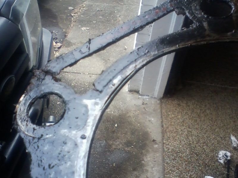

Could be. I got it because it has that bubble plastic and looks stock. Got the rebuilt heads in place. New guides and seals. Not technically difficult, but challenging because of the lift. Found the issue with the head gasket. I wonder if the composite failed and then the ring blew or vice versa.....Passenger rear. That's where I heard the 'pssst' sound a few times. Liners seem to be in place.
