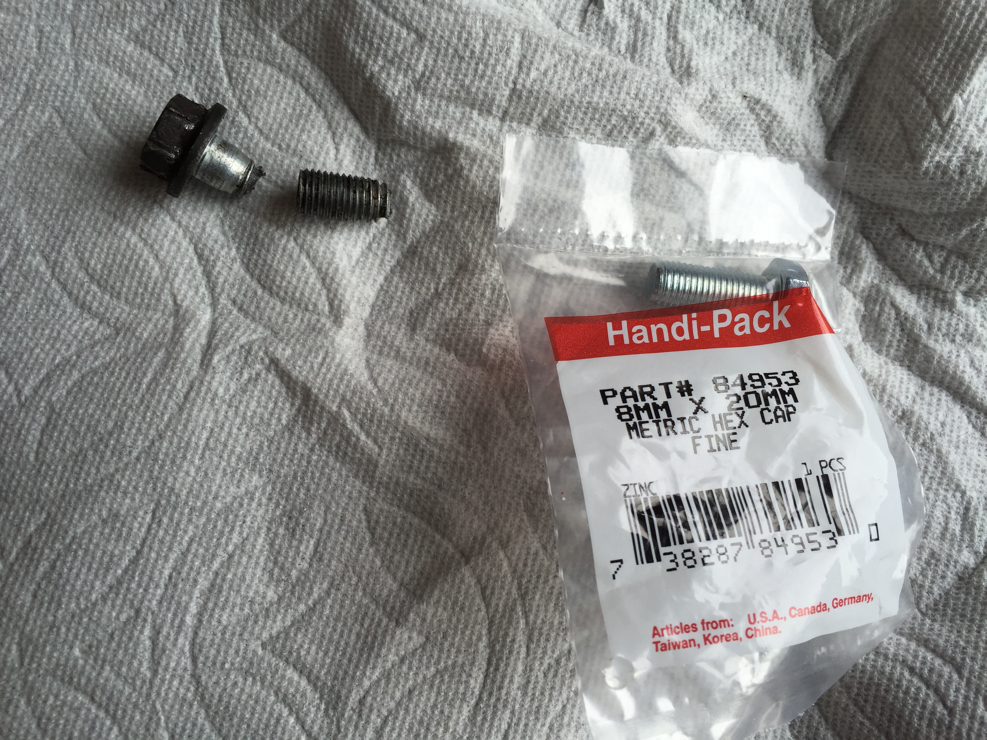

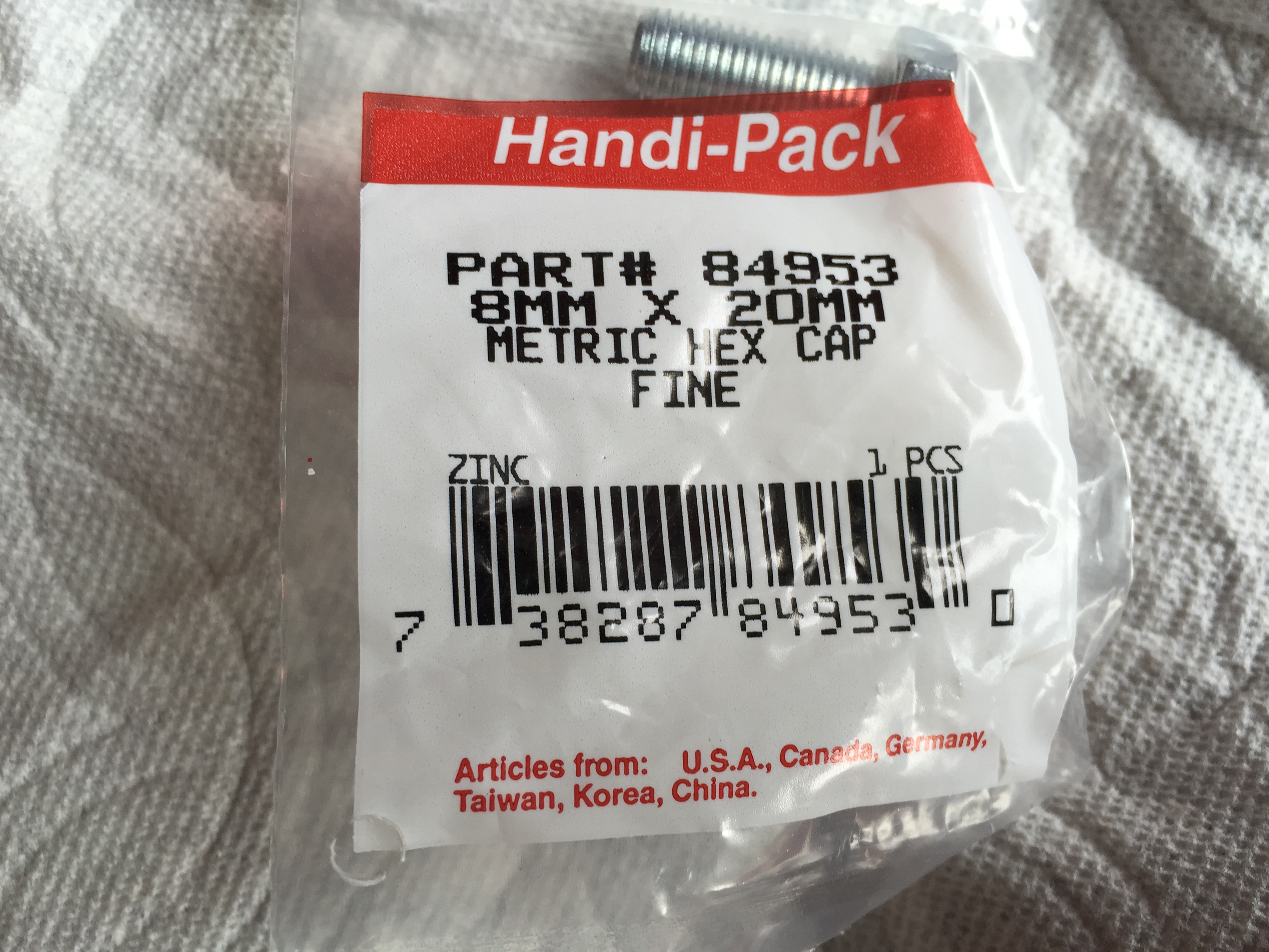

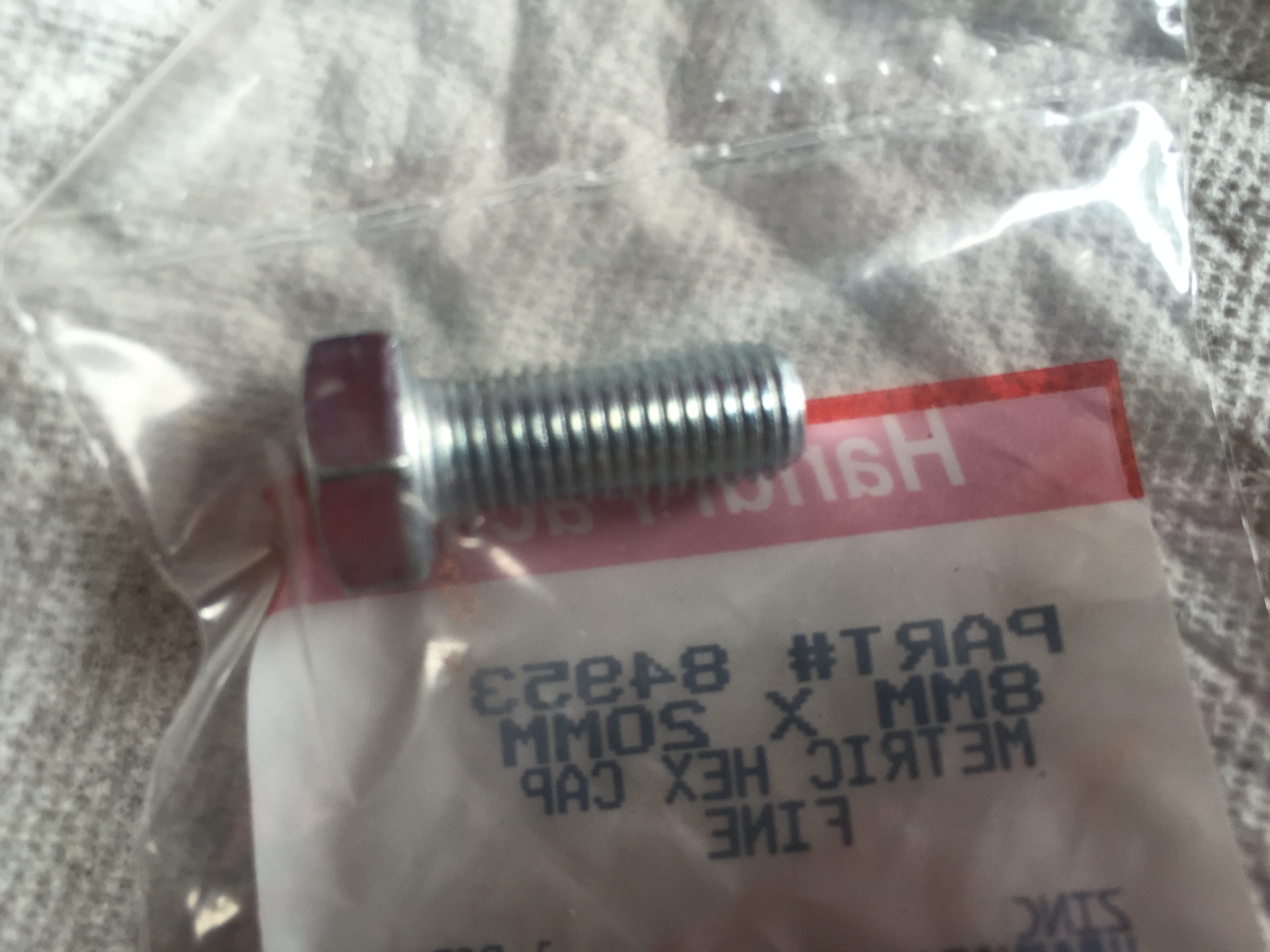

This morning, I went to change the front pads on my D2. This was the first time that I was doing it myself on this car (dealer did it all other times, yes I have changed brakes before myself). I went to take off the top caliper bolt on the driver's side and the head of it snapped right off! So I managed to take the bottom one off and I got a few replacements at the hardware store for 70 cents each. And it ended up working the same, but the head size is a 13mm instead of the old 12mm. Anyway, if anyone else snaps a caliper bolt, the size is: 8mmx20mm Fine thread.
I hope this doesn't happen to anyone else but if it does, you can buy that size bolt. It doesn't look exactly the same, but it fits and does its job like the old one.
Pictures coming soon.

Some pictures:
Attached Thumbnails For Your Future Reference...-img_0485%5B1%5D.jpg   For Your Future Reference...-img_0487%5B1%5D.jpg   For Your Future Reference...-img_0486%5B1%5D.jpg

Aren't brake caliper bolts typically made from high-tensile steel? You might want to check on that before your replacement shears off.

I'm guessing he's giving this as a quick-fix option, as nobody should use a standard fastener in somewhere as important as a brake caliper.

Yes, yes you all are correct. This is only a quick fix if you need the truck immediately. My new bolt is coming tomorrow, so I am not worried about using a regular galvanized steel bolt for a few days.
Sorry, I should have made this more clear in the first place.
Edit: I got these "real" caliper bolts from Amazon. I didn't need the pins, but this was the fastest way to get them:
Amazon.com: Carlson Quality Brake Parts H5060 Disc Housing Bolt: Automotive Amazon.com: Carlson Quality Brake Parts H5060 Disc Housing Bolt: Automotive
