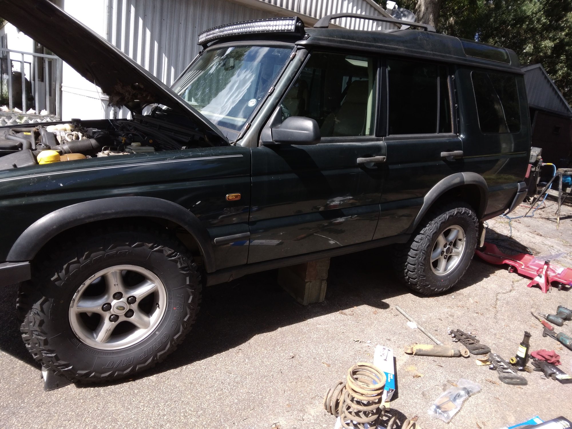

Before pic of the little ladies ride. 285 75 15 thunder track grip m/t tires. 700 shipped on eBay. I usually supply my own tires (I'm a dealer) but covid has my supplier's selection down to 25% of what they had 2 years ago.
The 3 inch "plus" Terra kit came from the great guys at lucky8. I'm east coast, shipping was 3 business days. Can't thank them enough for getting it quickly. The little lady demanded new tires and had to have bigger tires than my 1st gen 4 runner. Now she's got tires tucked tighter than a new audi.
This is her daily beater. Follow along for a diy on the ground lift kit at home garage. Im using all basic around the house tools other than the cheater train jack. I'd do this lift at the shop but I wanted to consume adult beverages and not be bothered by co workers and customers while i do it.

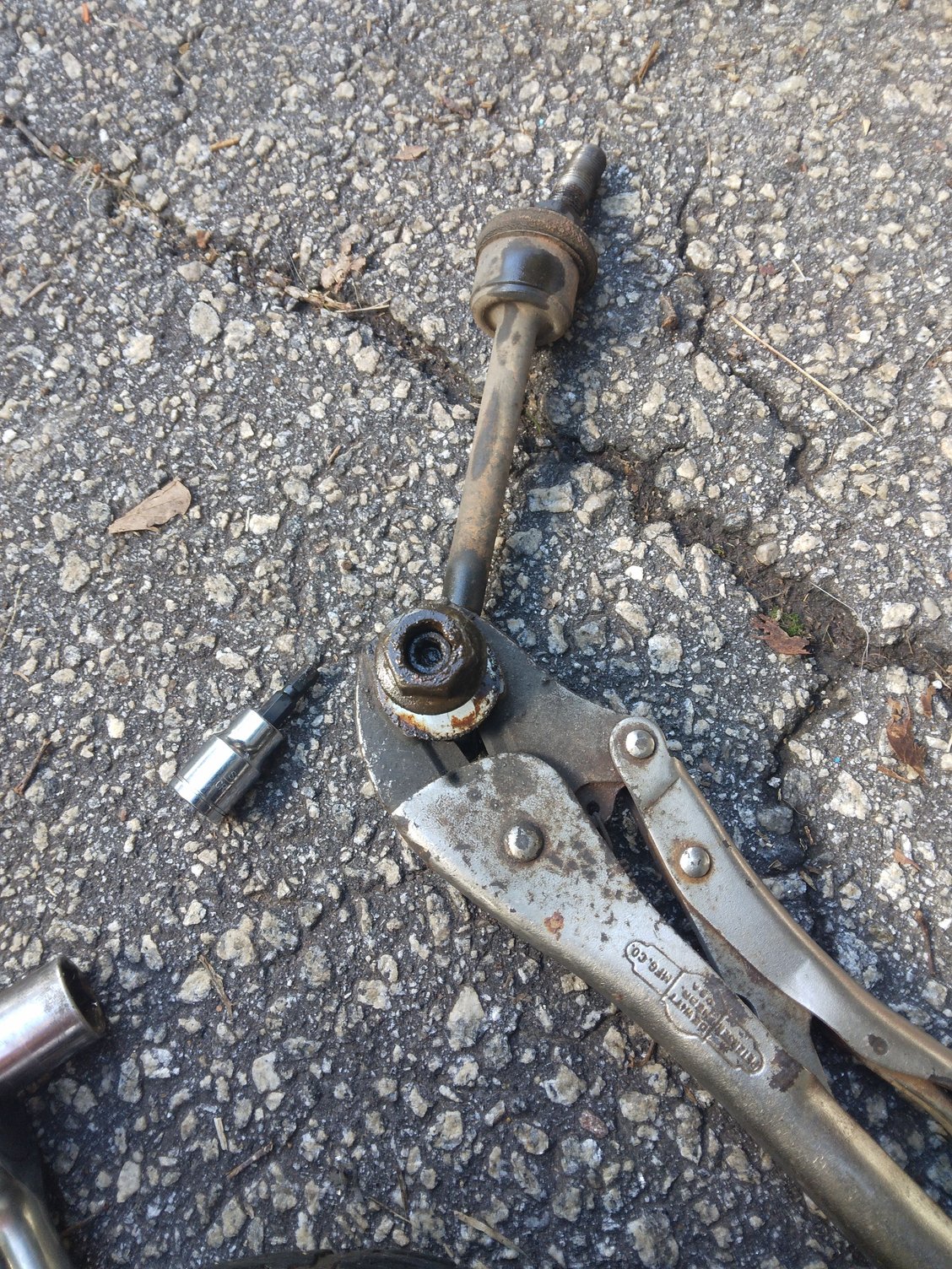

first snag was this dumb sway bar end link. This rig has never seen salted roads or coastal roads so rust isn't an issue. Still presoak all nuts and bolts with penetraint.
This allen in the end link is begging so snap an allen socket or strip out. At the shop I have nice name brand tools. At home I have cheap harbor freight spares. In comes a tool God made himself. If you don't like my God you can give credit to whatever entity you prefer. The fact remains that a good set of vice grips, even 20 plus yr old ones that have spent way too much time in a boat tool box are the most versatile tool ever made.
I tightly grip the back of the end link and she came right off with no fuss.
Forgive me for the typos. This is my first Samsung phone and the keyboard/auto correct hate me.

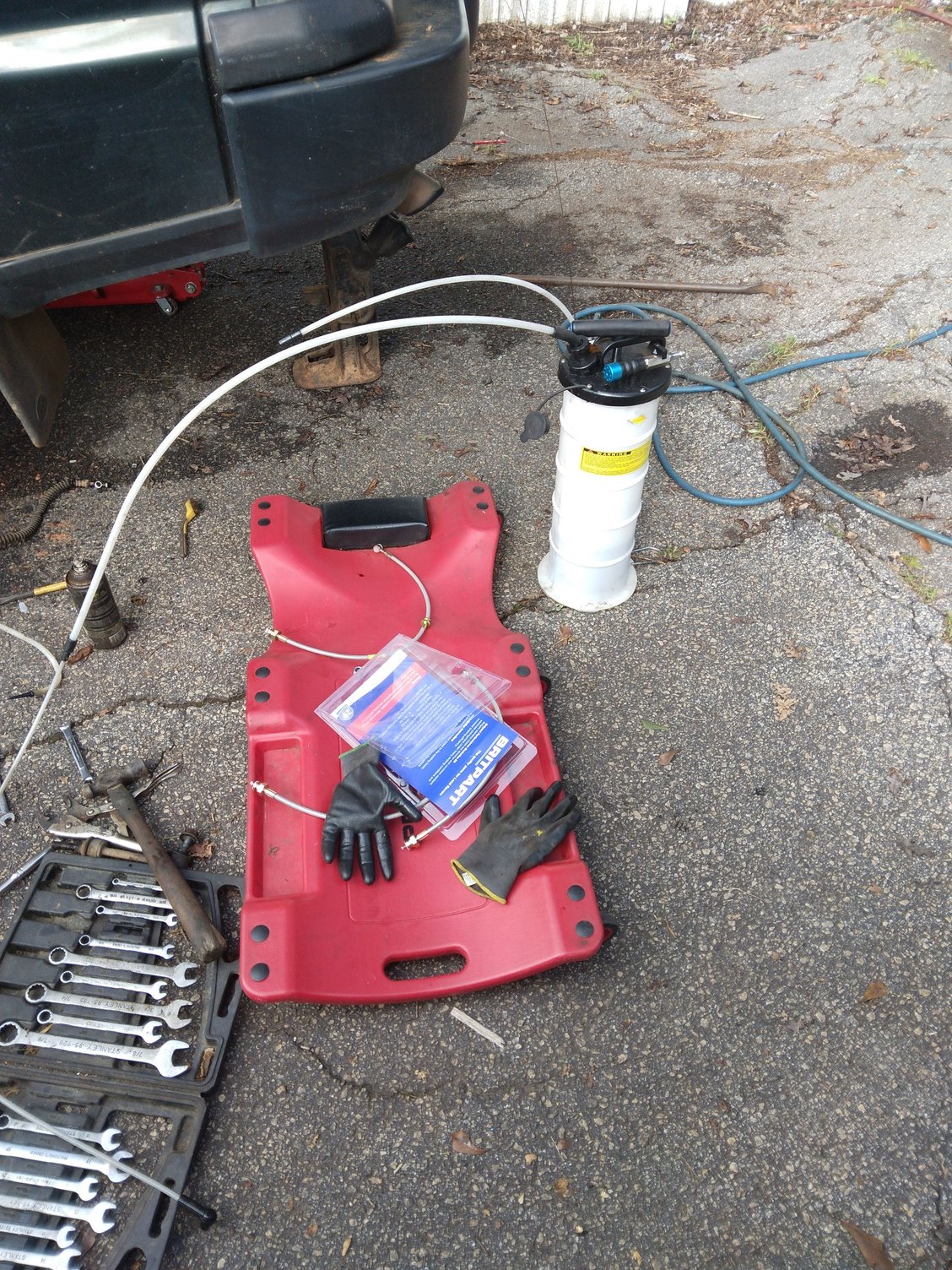

I fudged a little on the special tools. The admiral is hung over and not helping. Im using a manual/pneumatic oil pump to bleed the brakes as I install the new SS extended brake hoses.

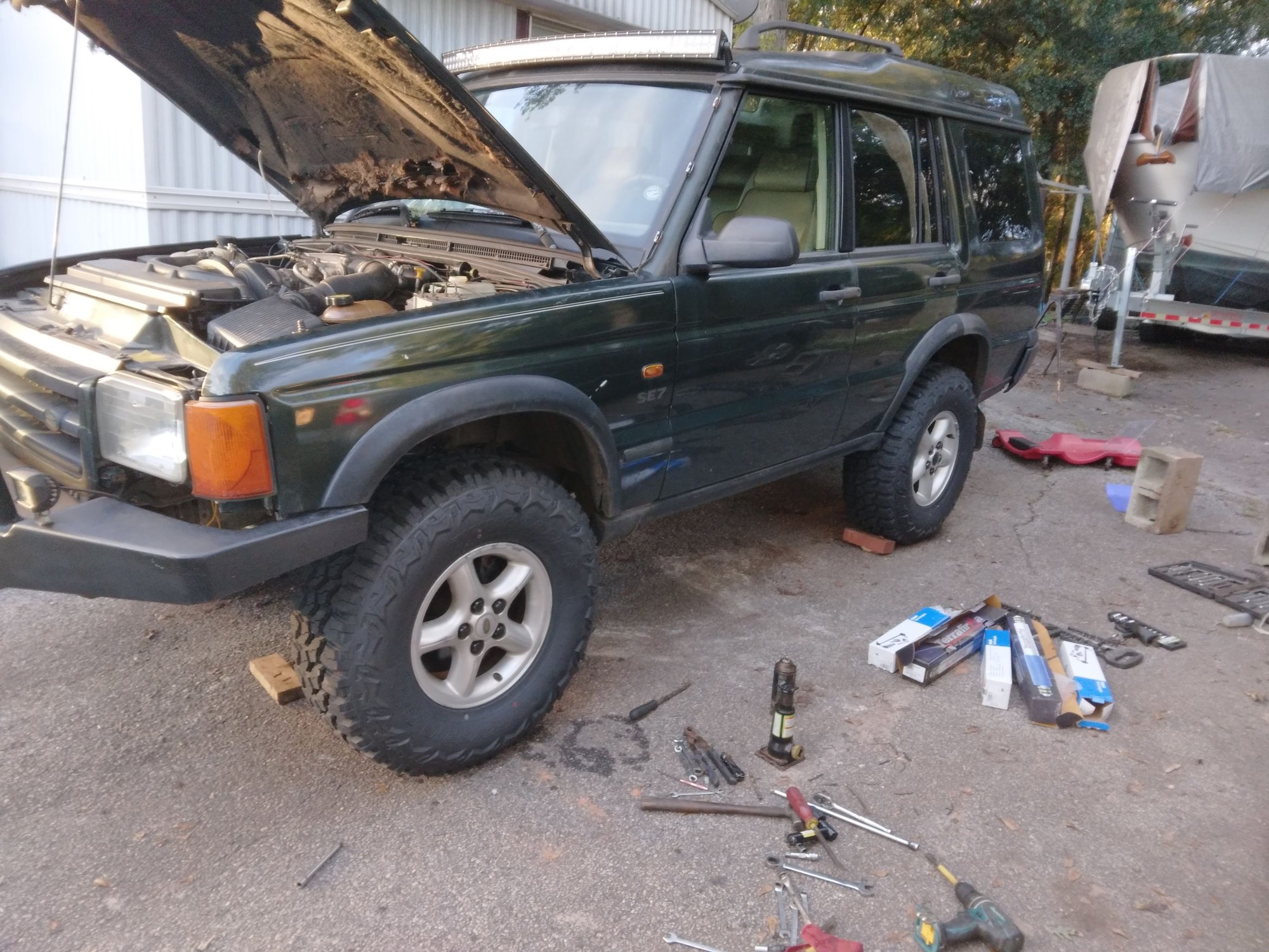

back lifted vs front

The front install was uneventful. Needed to use one spring compressor to slide the sping over its lower perch.
the bottle jack between the frame and axle is a must to get the spring in.
Gravity bleeding the brakes much easier on the front axle than the rear.
