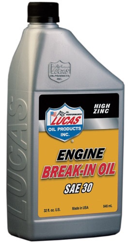

Lucas is what I use. I have also use that additive stuff in the past, but feel better using the regular full break in oil
Lucas Engine Break-In Oil 10631-1 - Free Shipping on Orders Over $99 at Summit Racing

Also that stuff is available at LPS

Dusty your lps are better then mine cause I am not finding that, just some stuff for $10 a quart ouch
I have never used spe dial oil. For break in , read the link is he saying just use good oil?

Actually the high zinc oil is most important for breaking in a new cam.....
He is saying after the first oil change, it's better to more frequent oil changes than to buy buy high dollar oil.
My pep boys had break in oil... Over by the assembly lubes
