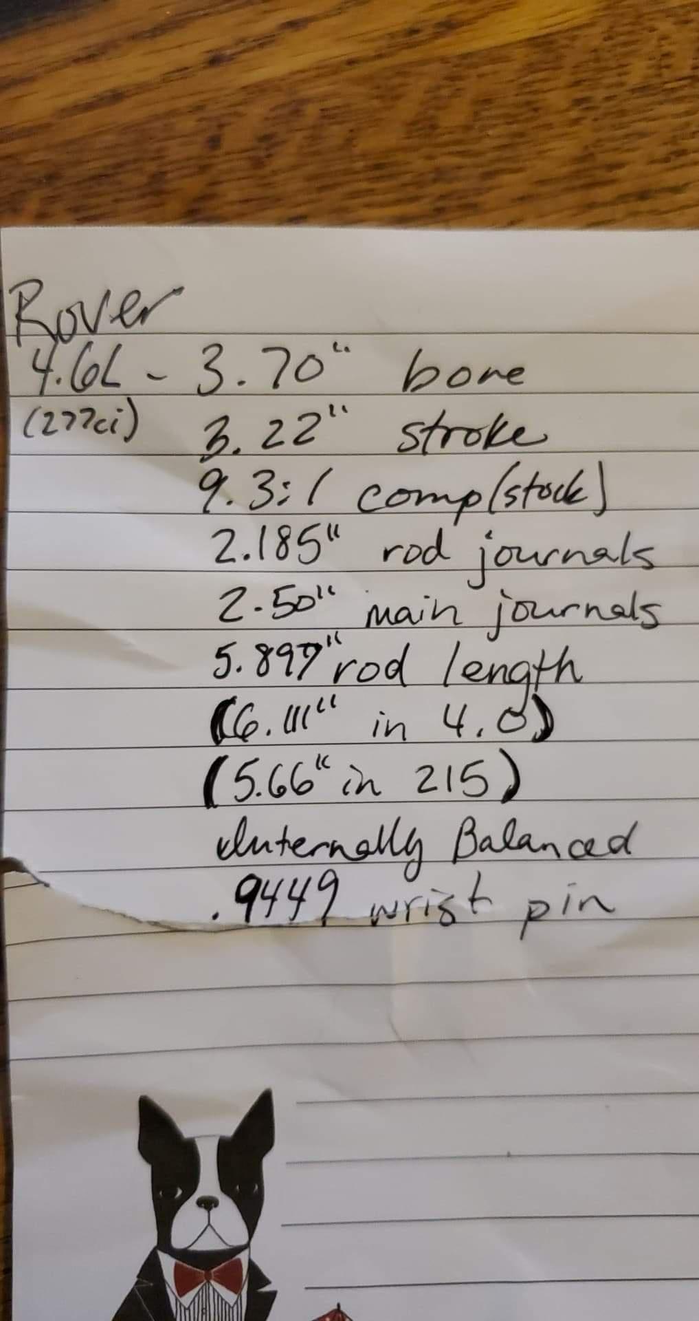

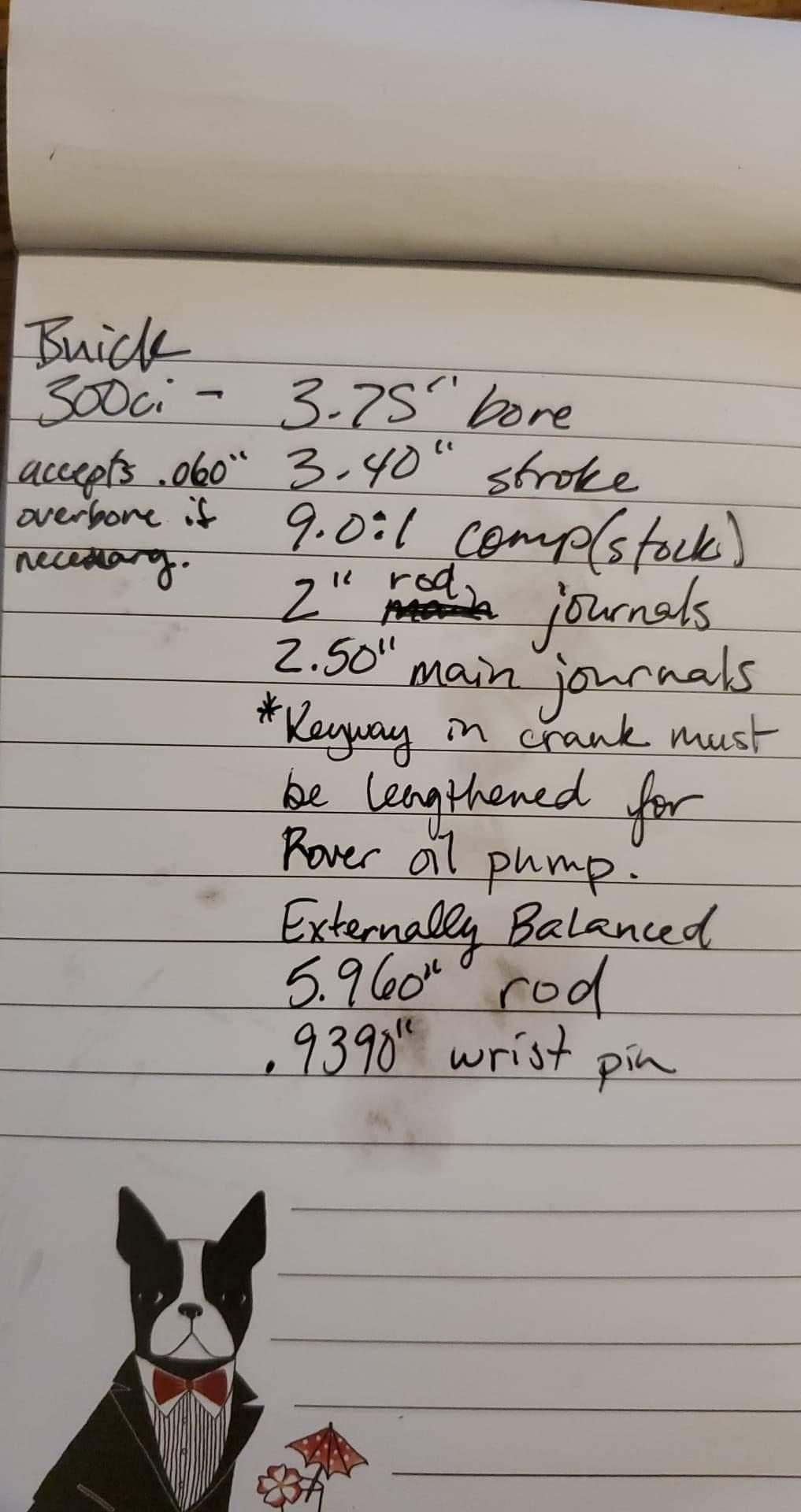

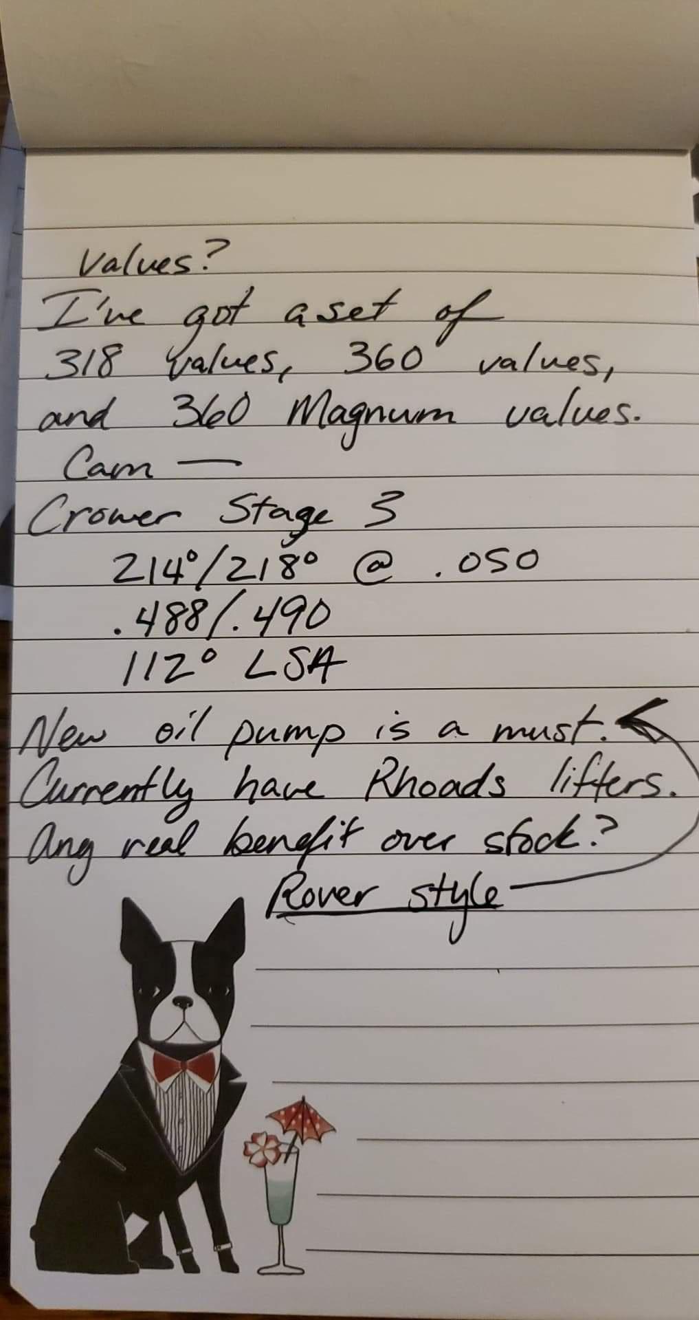

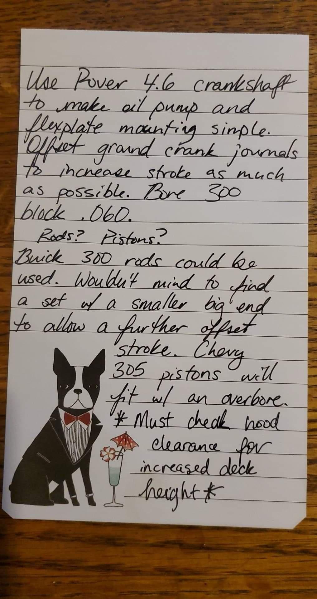

I'm including pictures of my notes below, but here's the short version. I think we're going to use the 300 block (again, pending confirmation that the bellhousing will mate up... I'm almost positive it will). We're going to use a 4.6 crank, offset ground to increase stroke. This will make using the Rover flexplate, oil pump, and balancer much simpler. If need be we will use the 300 rods, but I'm hoping we can find another set of rods with an even smaller big end which would allow us to go that much further with the stroke. Block will be bored, most likely .060. Pistons are yet to be determined, but you're getting into the size of 305 chevy pistons there. That will help decrease cost as long as the length will match up with our rods.
I've got a Crower Level 3 cam that we're going to use. Specs below. I'm going to port the 300 heads some and we're going to put big valves in. I've got three different sets we can choose from. We'll also do a 3 angle job I'm sure.

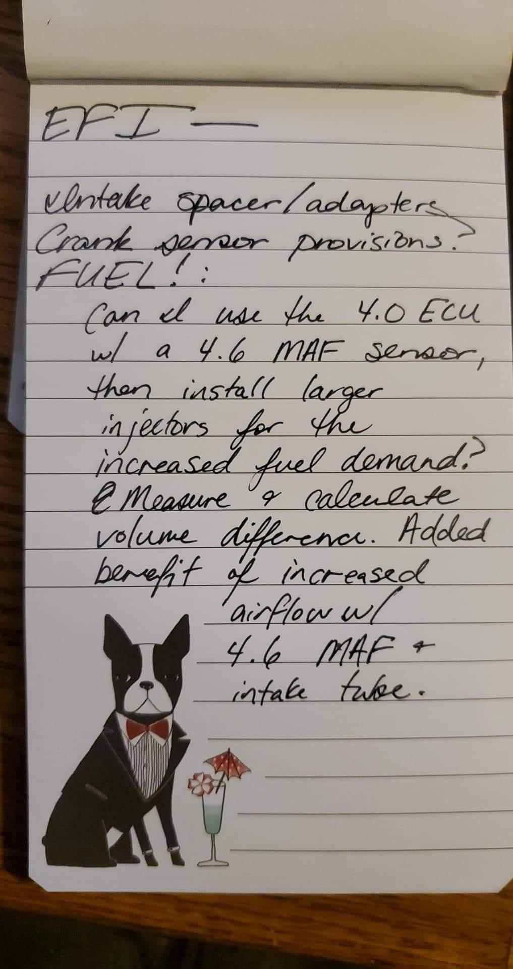

The idea here is going as big as possible. To address fuelling demands I'm considering the idea of keeping the 4.0 ECU and using a (larger) 4.6 MAF in conjunction with larger injectors. That is, if the numbers line up right. I need to measure the MAF bodies and crunch the numbers.
Intake will have to be adapted for the taller deck height, but I don't think that will be too difficult. The rover starter bolts up according to my research. The trickiest part, I think, is going to be adapting the crank sensor. The ear on the block will have to be drilled out and a couple holes tapped. May have to shim or grind out for depth.
Anyway, here's all the numbers.
