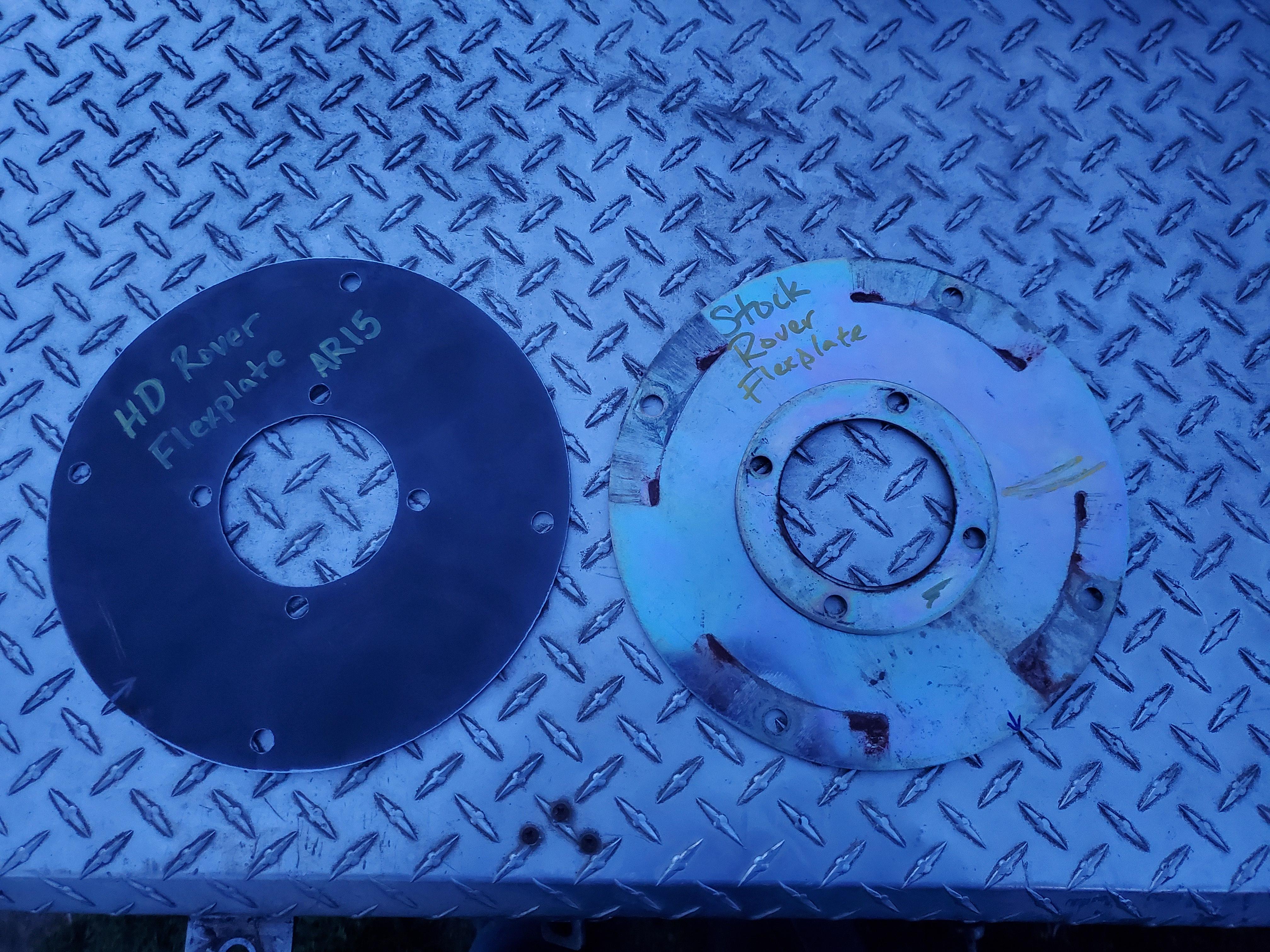

Got the first major piece back today! HD flex plate made of AR15 steel. Just about double the thickness of the stock flex plate. This should definitely hold up to the power. Had it cut by a buddy of a buddy who has a plasma table.
As for being an alternative to an LS swap... I don't really see it as that. This will be super neat, but more costly only to end up still making the same or less power, and then you're also still stuck with the Rover ECM *unless* you swap in a Disco 1 transmission (hydraulically controlled instead of electronically) and use a carb/distributor on the motor. Otherwise you can still get stranded by a bad CPS or a grenades Rover oil pump just as easily as a Rover v8. This effectively only addresses the head gasket issues while also giving an increase in displacement and therefore power.
With that in mind, *if* there were enough people interested with cash in hand, yes, I would offer the adapters.
