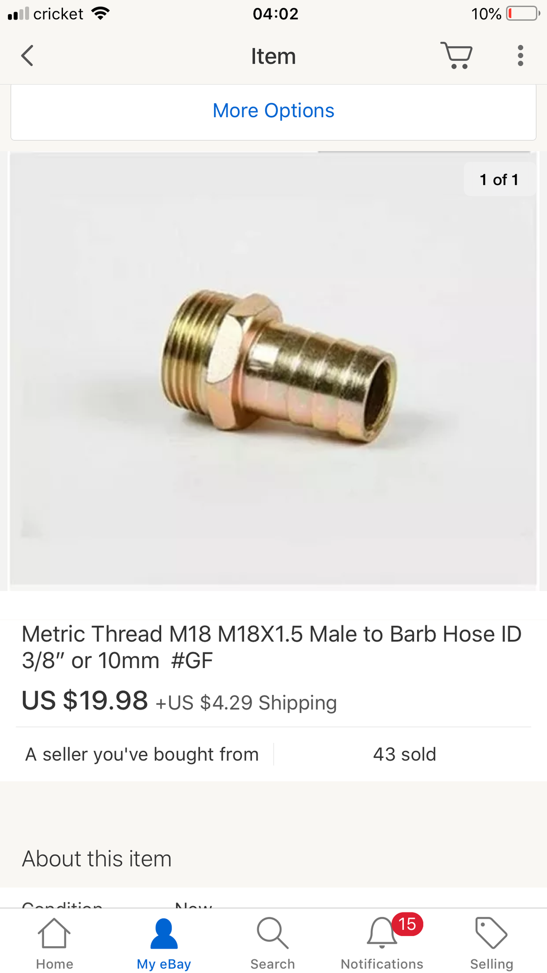

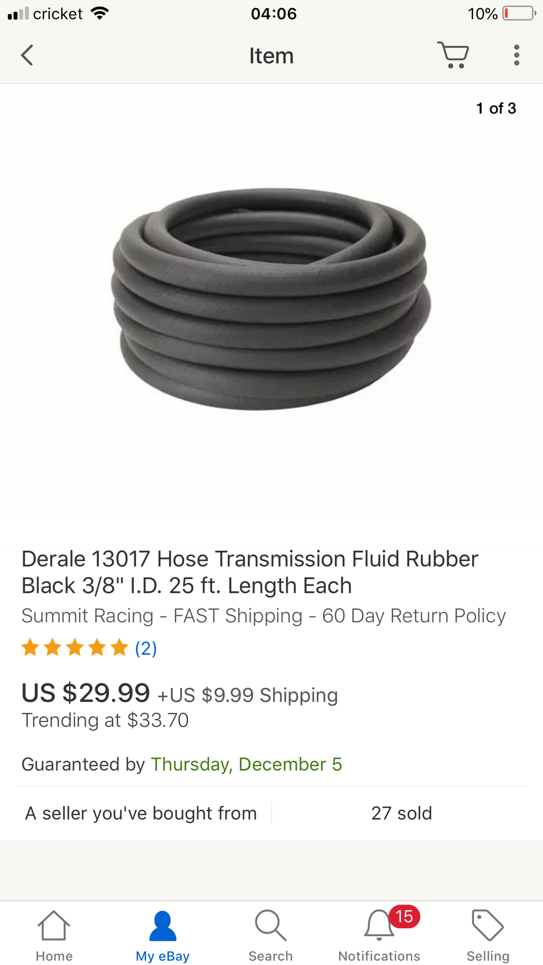

Also, to everyone following. Thought I might add another alternative to the trans cooler.
attached are pics of the parts I used. I found the m18 fittings that fit appropriately without any leaks and ran high pressure rubber hose to the trans cooler mounted between the rad and condenser. Thought it might be helpful/cheaper alternative to those of use without easy access to a hydraulic shop.
