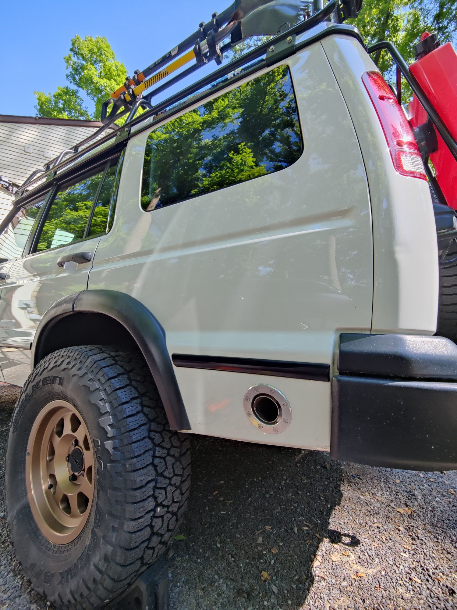

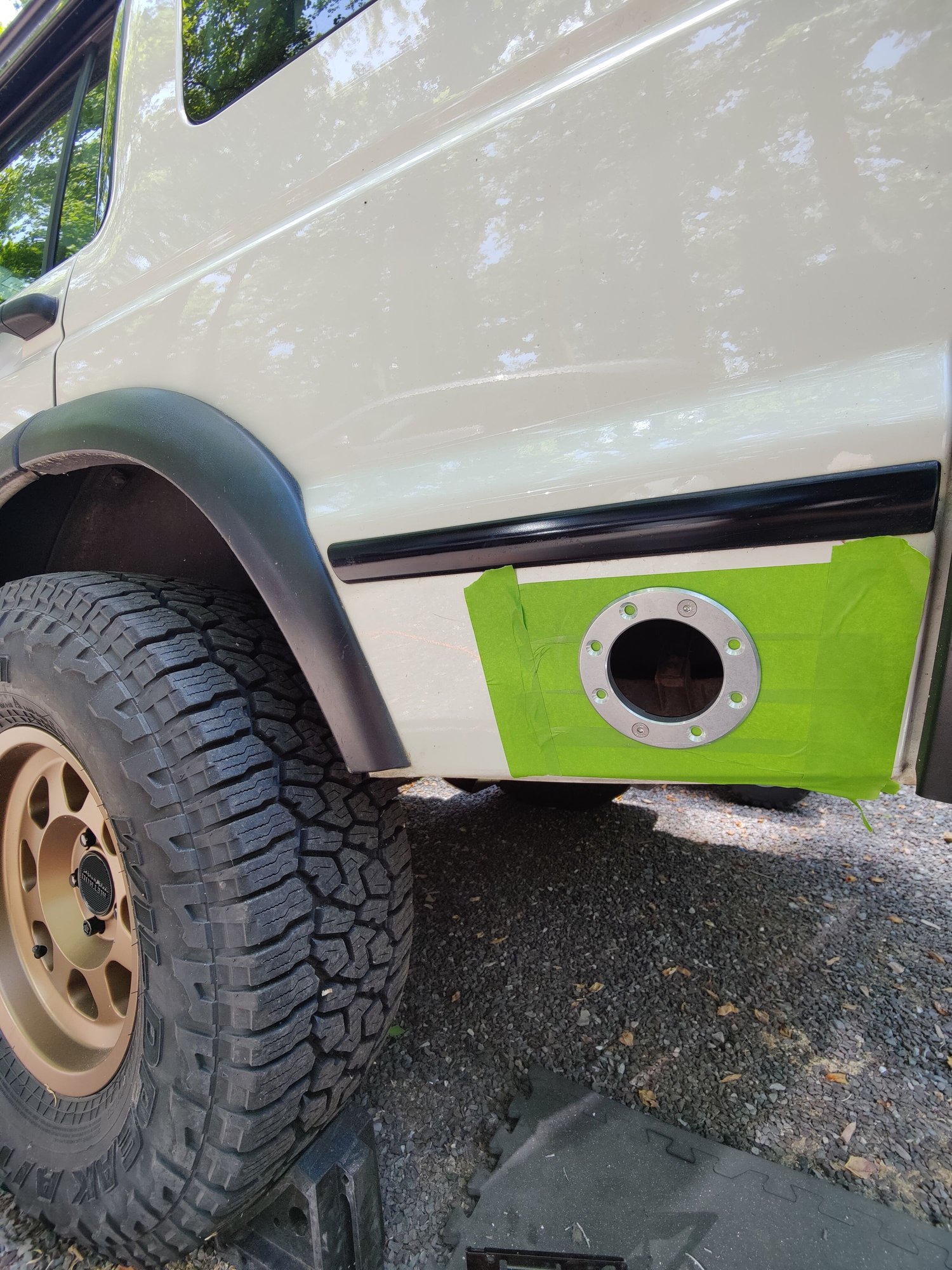

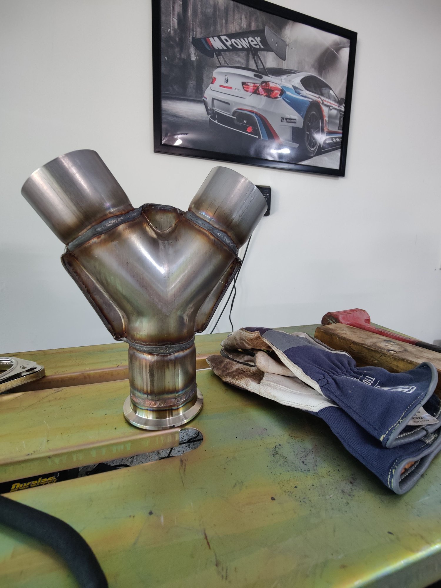

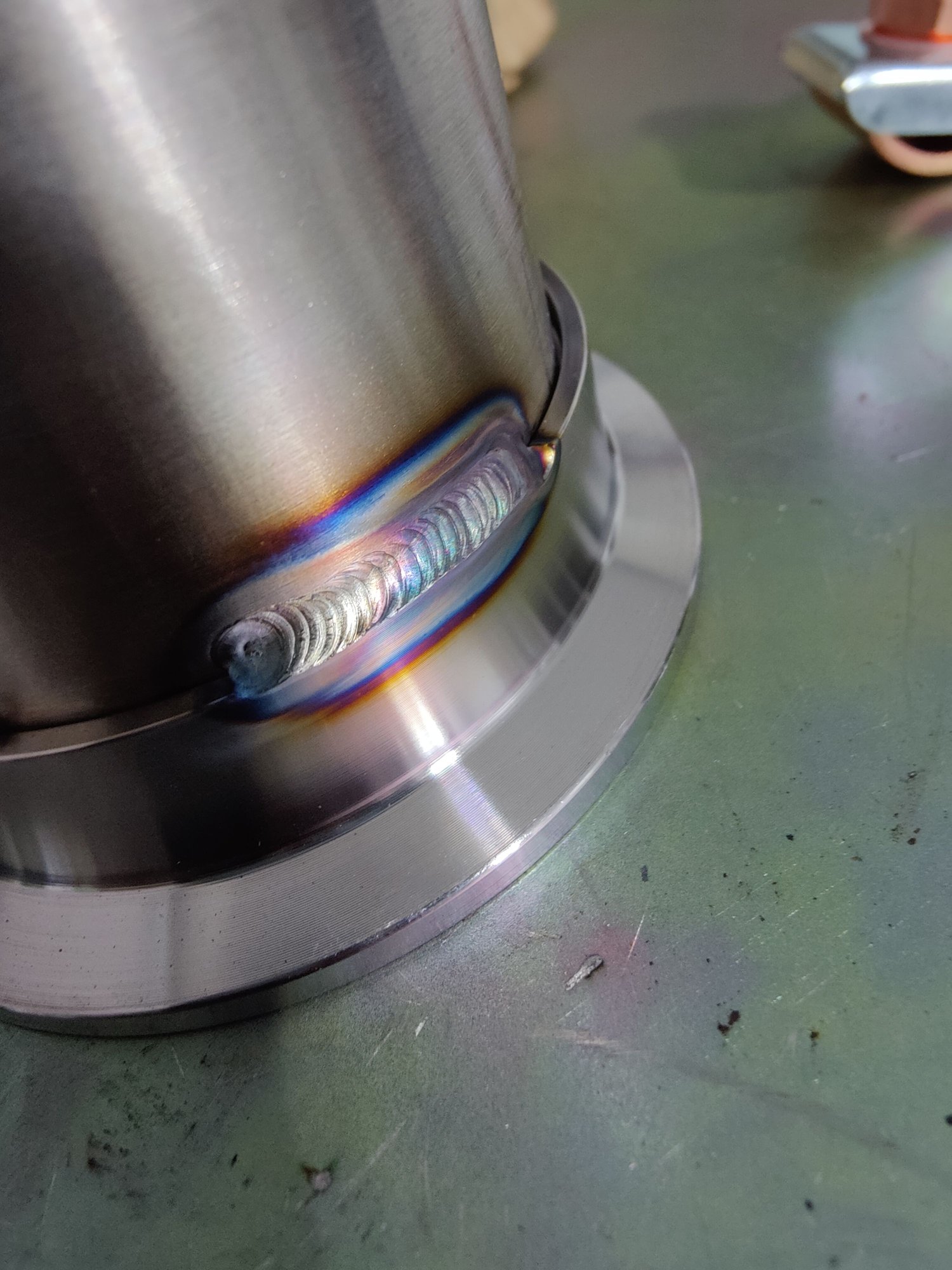

A few more updates... I taught myself years ago how to weld but had no plans on doing the exhaust. Was going to go the easy route and have someone make it for me but after reading some reviews on the HF Vulcan tig machine I decided to buy it to do this project and have it for any future needs. It works well for $850 after memorial day 35% off!
I also chopped the rear muffler off and sliced all the stock bolt flanges off that were rusted to hell and replaced with 2.5" v-band clamps. I'm still using that stock center section for now. The side exit will hopefully fix my problem of getting the rear muffler hung up on rock obstacles. It should also give the engine a nice sound being that it's cammed.
Have always loved those method wheels. Especially that color on the white disco. The welds and the placement of exhaust is awesome
