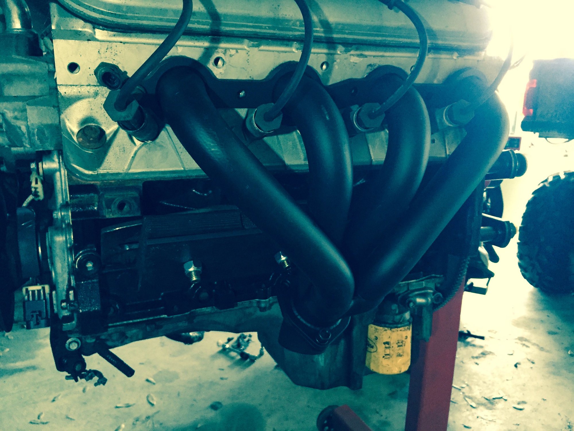

On another note: We have been messing around with these headers, which seem to fit if you don't mind a little bit of hammering. They look great through:

Terrafirma lift kit is half way in! Just waiting on the new strut/shock towers to come in for the fronts.
Ace - thank you so much for the update on the progress of the kit. At what point would you feel comfortable giving us an estimate of costs? Was recently looking at some swap kits for Buell motorcycles and was blown away by what the company was asking ($12k). Just want to make sure this will be within my expected budget.
With the amount of aftermarket support for the LM7 vortec's there has to be a set of headers out there that will fit without hammering, no? I wouldn't mind buying them separate from your kit if I don't have to hammer away at something.

The headers are something we've been trying out for this build specifically. Both earlier times we've used some aftermarket manifolds that fit fine and there are others that will probably fit. We're not going to include manifolds in the kit, but we're building up a 'recommended' list. The swap should be able to be completed for around $5k including the kit, budgeting for a good used engine, and all the other parts that you need to buy. It could be done for substantially less if you get an engine at a great price -- or a package deal with an engine, wiring harness, ECM, and sensors. While the kit will go up slightly in price from the previous estimates, we are including more parts, which means the overall cost of the swap isn't going to change much.
In general terms, things you will need to purchase separately:
Engine ~$700
Wiring Harness $550 (eBay harness could be $330 option, or included with engine)
GM ECM $200
GM Sensors $300 (MAF, O2, MAP, etc. may be included on engine)
Oil Pan $250 (highly recommended)
Exhaust Manifolds $200+
Intake hoses / coolant hoses $150
Accessory drive belt, pulleys, tensioner, etc. $100
Fluids $200
Random other parts $200
