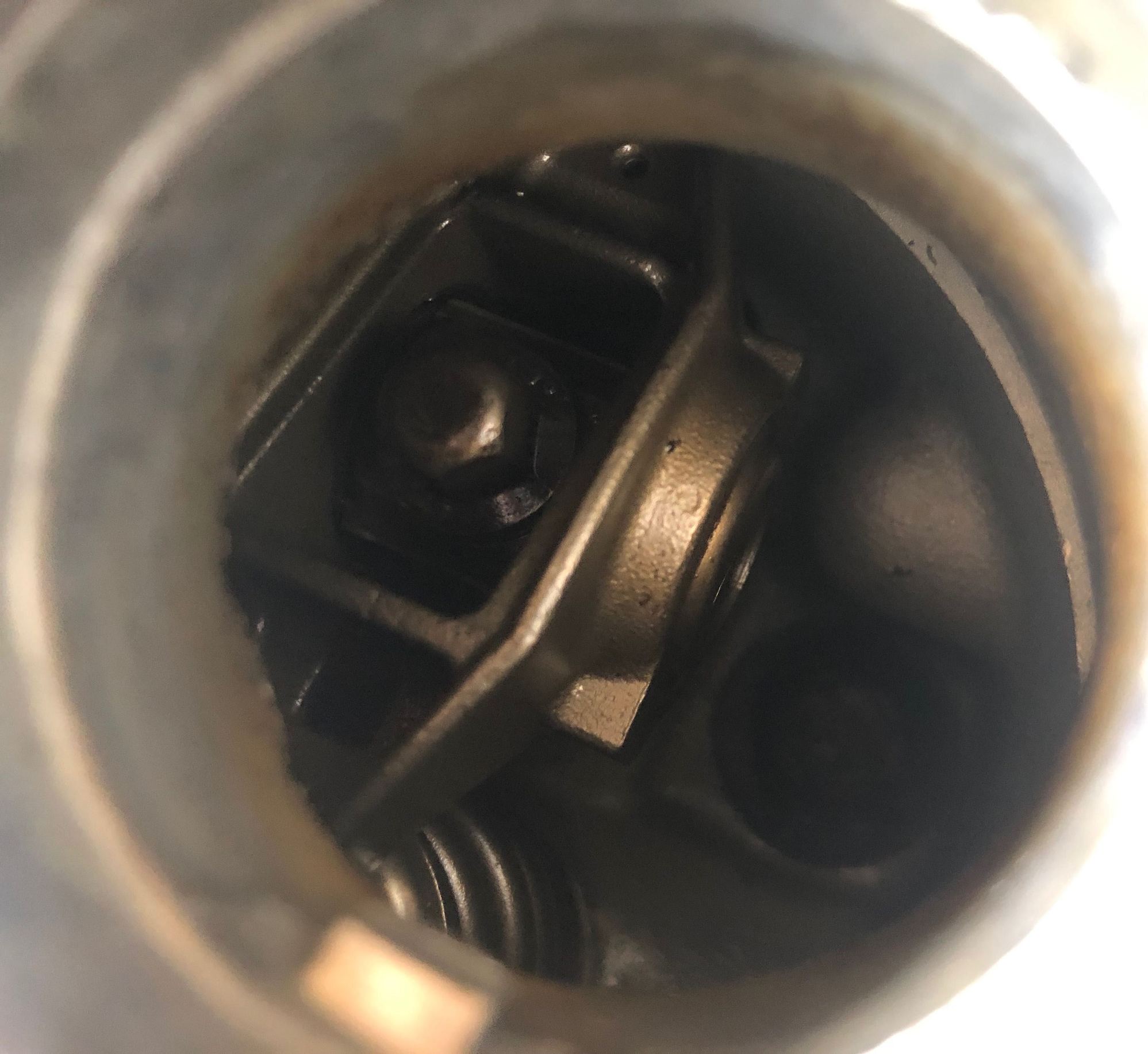

Picked up a pair of 5.3L LM7 engines for $400 each. These have the iron block with aluminum heads, but they were in great condition. It turns out one of them was recently remanufactured (stickers still on the block and all) and looks to have only been running for a few thousand miles before the truck was crashed -- quite a find!
