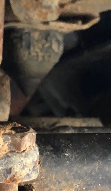

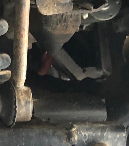

I have taken a further look at the articulation and tested it with a jack. This test is not perfect and obviously does not represent all off-road conditions or consider all factors that would only be present at speed, but shows that after a 2-inch lift this does not appear to be a major issue.
I have two LS Discovery’s to test. Both had an earlier, prototype version of the kit, so there are some differences. Both trucks had aluminum-block LM4 engines and 2” medium duty Old Man Emu lifts. One also is equipped with a significant amount of extra gear including a metal front bumper, winch, roof rack, roof tent, and other offroad gear (which is sagging in the front slightly after the conversion and probably should have a heavy duty lift kit installed). Both have 31.5 in tires.
In addition, I was able to use one bone-stock 2003 Discovery with stock suspension, stock tire size, and stock 4.6 engine. With all the trucks, I lifted the passenger side of the front axle until the drivers-side wheel also came off the ground. Since the other wheel was lifting, I figured that was about as much as the axle would flex without disconnecting the sway bars and other modifications, unless the weight was shifted forward, or other circumstances. I looked at the bumpstops, and clearance from the driveshaft to the bellhousing.
On all the Discovery’s (even the stock one), the driver’s side tire lifted off before the axle hit the bumpstop. I tried to take some pictures, but the lighting wasn’t great.
On the 2003 factory setup (at liftoff of driver’s wheel):
On the LS Disco with lift:
During the test, even without clearancing, on the LS Discos the driveshaft was not contacting the bellhousing or adapter and had a small amount of room (can be seen in background of the second photo above). Both the LS trucks responded similarly. The factory spring compresses a bit more than the Old Man Emu, as expected. The two setups seemed to have similar amounts of flex before the driver's wheel lifted off (maybe a little more with OME lift). Also, the driveshaft does not seem to move all that much despite the axle flex.
That being said, I can see how some people may want more room around the driveshaft or to extend the bumpstop if they are concerned. As shown in the photo above, there is a lot of metal in that area of the adapter and bellhousing that can be ground down or cut off.
