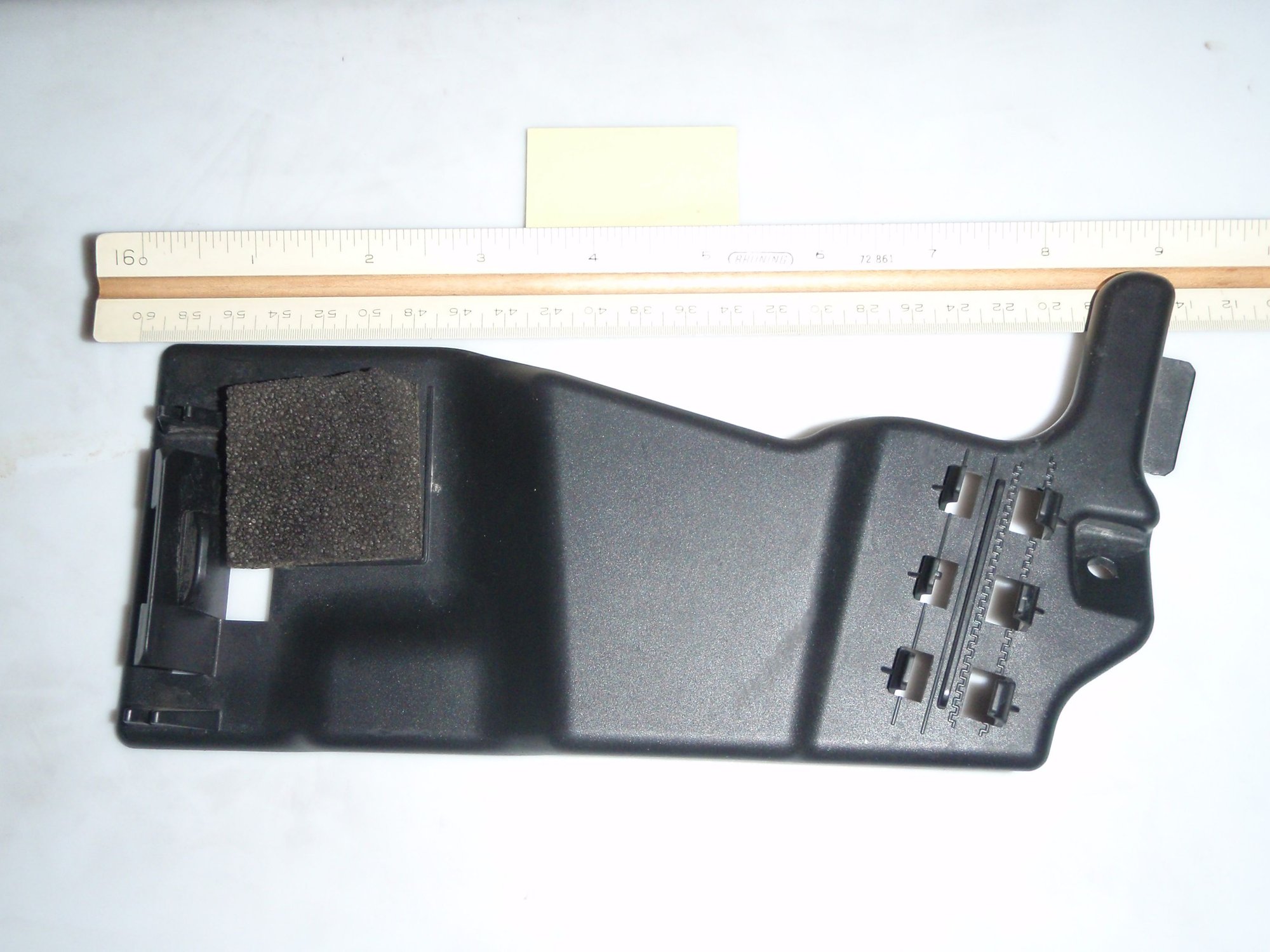

Seems like it hooks into something on the right side (of this photo) and the release os on the left by the pad.
this is the back side. Again the left here has that hook that inserts into something.
Unintentional trivia question but my LR dealer was clueless.
Recently had my 2011 RR Lux in for a recall on the brake line. The weather cleared up so I took the opportunity for a mid-winter detailing. While cleaning the engine compartment I found this part laying loosely on top of the air box. Took it to the dealer and he had no idea what it was. So I was hoping that someone would recognize it and tell me what it is and where it goes.
it is about 9 inches long by 4 inches tall.

Some one mentioned it goes over the ABS block. Still didn't look correct. Seems to have many baffled. Would really like to get it back to where it should be.

It does go by the ABS, it is to hold the windshield washer hoses and heater cables.
It can be a little tricky to get in place correctly, but it goes the way pictured in the first picture, with the left side of the picture facing the front of the vehicle.
