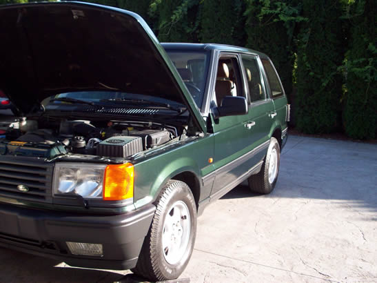

Although this is on the discovery forum, I figured I would post one for the RR forum, even though they are the same engines. You will need, a screw driver and a bottle of carb and choke cleaner.
First thing is to put the rangie's left tire on a stand so the cleaner will spill into the intake, instead out of it. (I drove the rover only half way up the ramp).

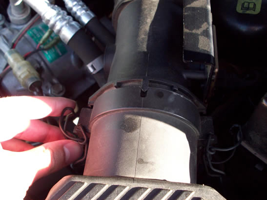

Next is to disconnect the MAF from the filter by undoing the little latches and then removing the intake pipe from the manifold by loosening the screw on the clamp. It should come off with little to no effort.

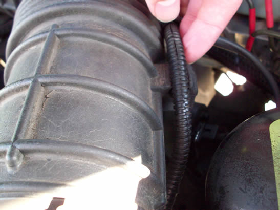

You may also want to remove this wire from a slot on the intake pipe, it enables you to simply move the pipe out of the way instead of having to disconnect everything (take care not to damage the wires and refer to the 4th image).
