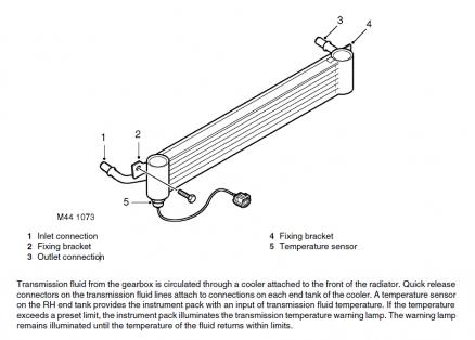

With this warning coming on intermittently, I wonder if the Temp sensor on your transmission cooler is going bad. If your 97' is like my 00' the transmission cooler should be in front of your radiator. Sensor is #5 on the picture I attached. After looking up the sensor it's not exactly cheap. This is only one of the first ones I found while searching.. It was about half of that on roverparts.com but out of stock. Let me know what happens cause now I'm curious to see what fixes it.
