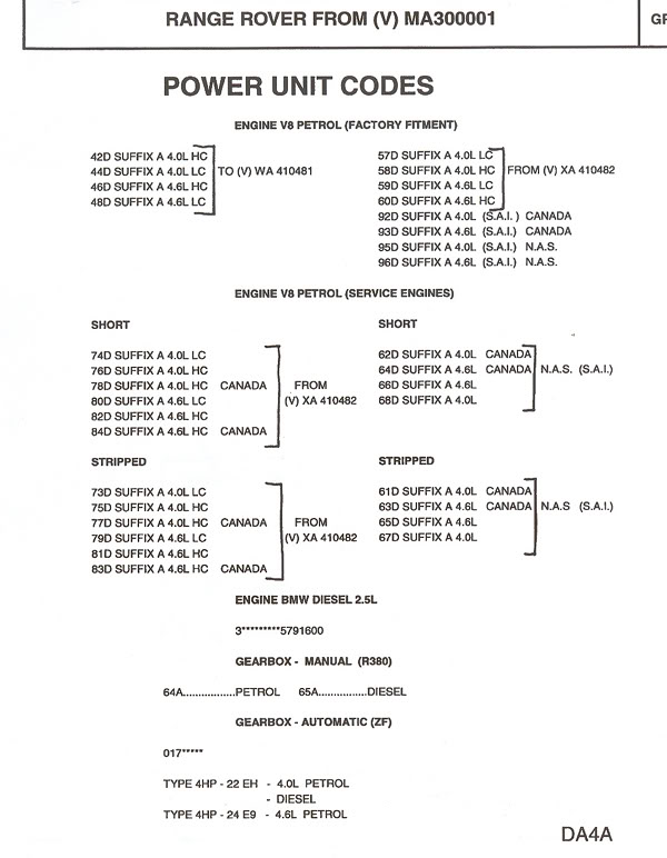

There is no real visual difference between the 4.0 and 4.6 engines. The best way to ensure that the engine you're getting is the right one is to have the salvage yard to provide you with the engine number stamped on the block. When they provide you with the engine number, cross reference it with the engine codes shown in my attached image. That will tell you which engine it is. Hope that helps! Let us know how it turns out!

Oh yeah! To find the engine code, look just off to the left of where the oil dipstick enters the block, the engine code is stamped there.

Thanks, but it'd probably be in your best interests to reference the number BEFORE you get the engine. If it's not correct, saves you the trouble of fighting the salvage yard and return shipping, etc. etc. If I were you, I'd call the yard and tell them to provide that number before they go shipping engines all ***** nilly.

Ahh, yes, definitely Bosch. I'll check the stamp number using Rockcity's sheet.
