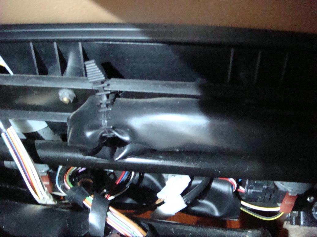

Well, can someone tell me by this picture under the drivers side seat what wire to play with that might be part of the problem with the airbag fault?
Thanks for any help.

Well all the SRS stuff should be yellow but I forgot to mention it's really hard to see this plug. As in nearly impossible. You'll probably have to reach around a bit to find it.
Since I can't figure out how to post a picture here i'll pm one that might help.

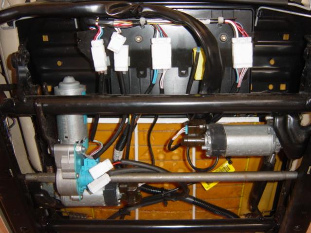

For the SRS/Airbag warning you're going to want to get a flashlight, raise the seat as high as it will go, and peak around under the seat until you find the SRS connector. It should look something like the picture i'm attaching (although this is a shot of a non-power seat so you may have a lot more cables running). When you find it, unplug it and try replugging it firmly. Turn on the vehicle and see if the lights are gone. If they are you might try leaving it alone and see if the warning message and light don't come back. If it does it may be time to tape, glue-very carefully!, or replace the plug. Sorry there aren't better instructions but the configuration of the plugs seems to vary a bit, not just from model year to model year either.

Here's the underseat shot.
