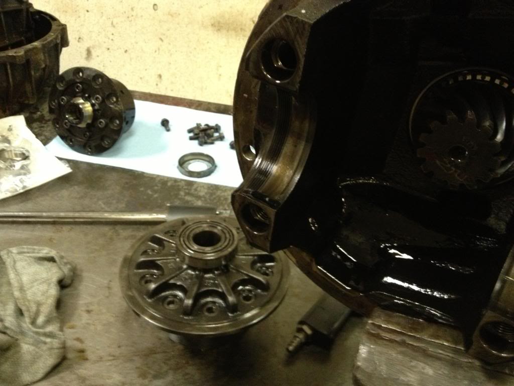

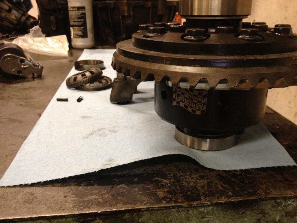

With the rear differential out of the truck we took it to the secret layer of lucky8's diff Jedi. It is rumored that he repaired an LT230 by only using his feet. I don't know if it's true but when I showed up he was wearing his shoes on his hands. Here's a look at the Black arts involve in upgrading the carrier.
Checking the backlash on the ringing pinion before dismantle.
Out with the carrier

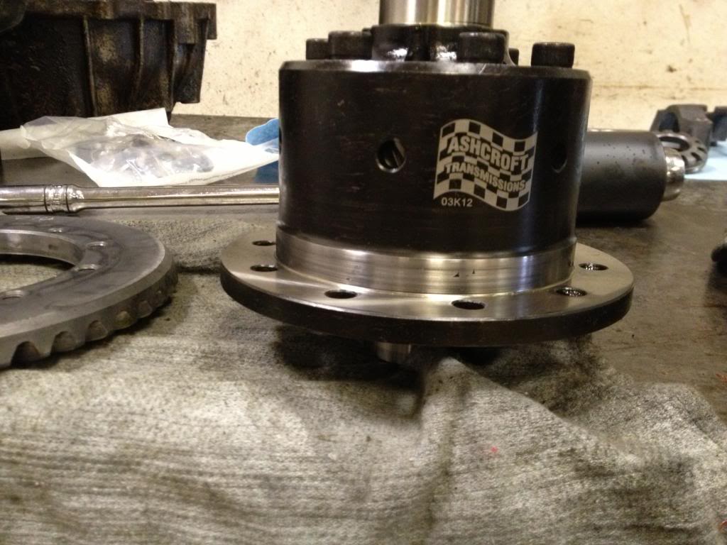

The ABT unit ready to take the place of the week factory carrier.

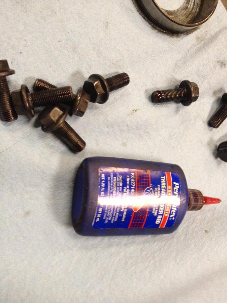

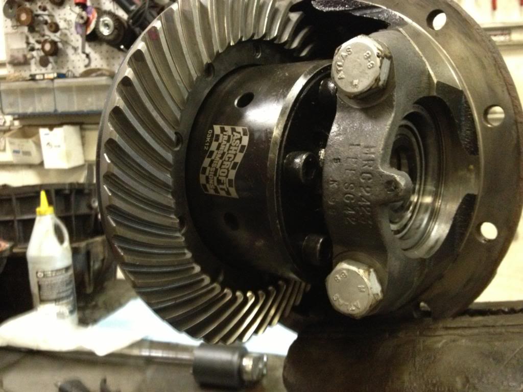

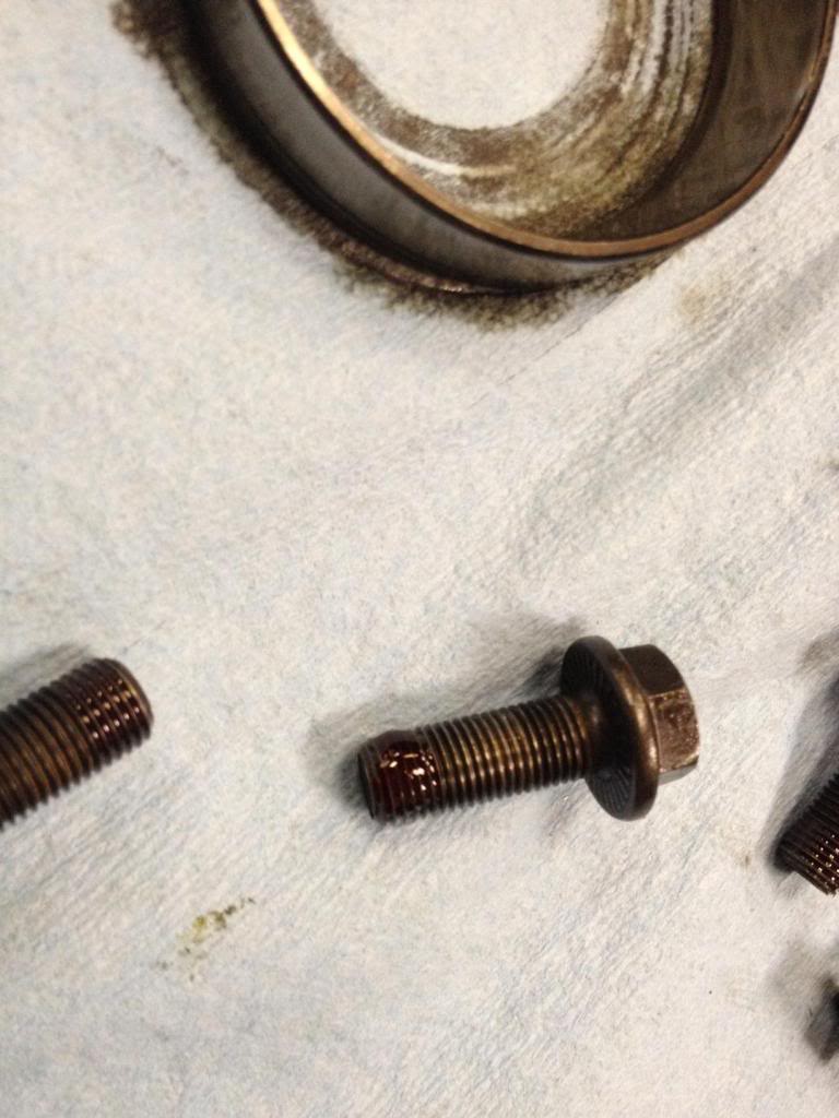

If you ever give this a go on your own I cannot convey enough how important it is to use Loctite on the ring bolts.
It is so important it deserves a second picture

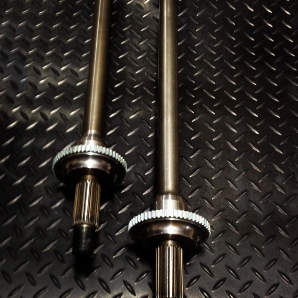

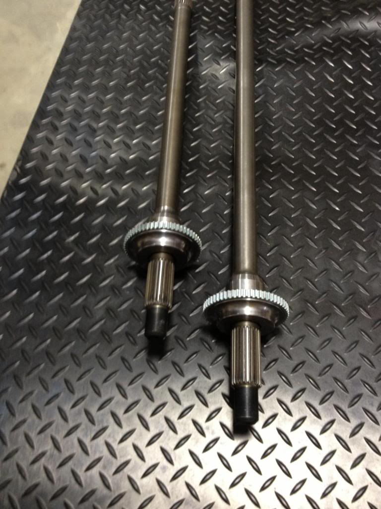

With all the extra weight we planned on carrying it was not worth betting on stock axles to get the job done.
It was time for a set of Ashcroft heavy duties!
And yes they are ABS compatible.

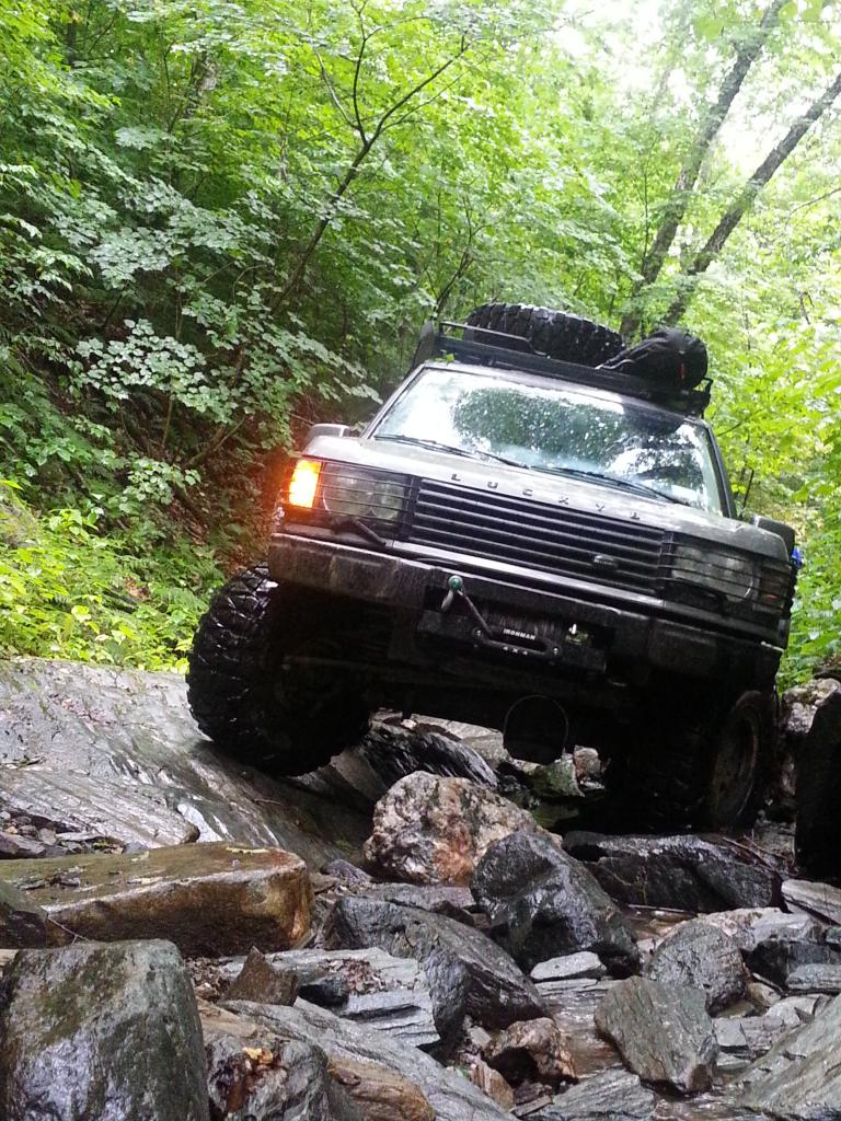

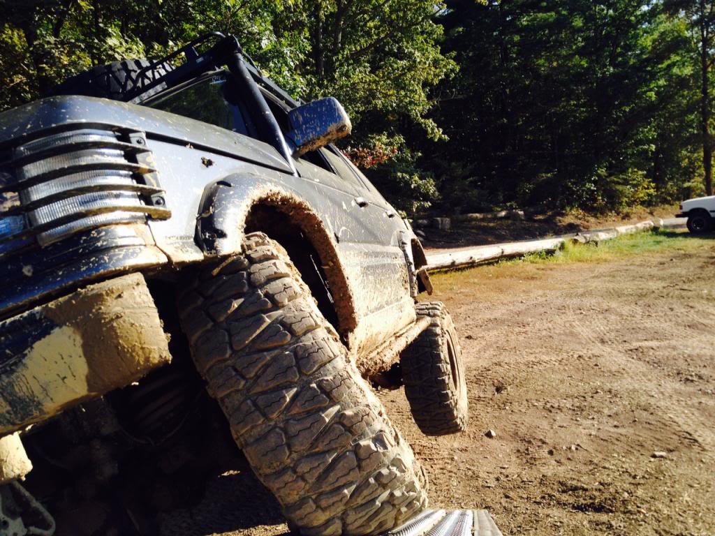

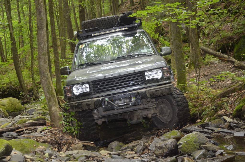

The ABT did fantastic for us at VOT. Aside from a little noise during low traction situations you would not know it was in the truck.
L8 VOT Team

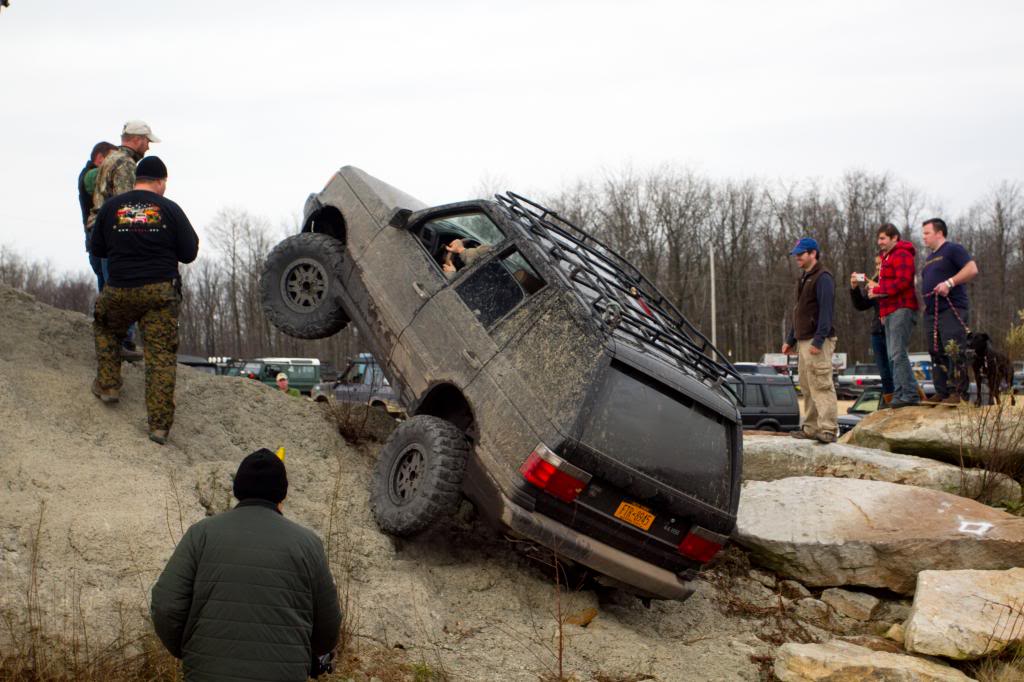

The take away from this adventure is the ABT provides an incredible amount of traction when combined with the ABS system.

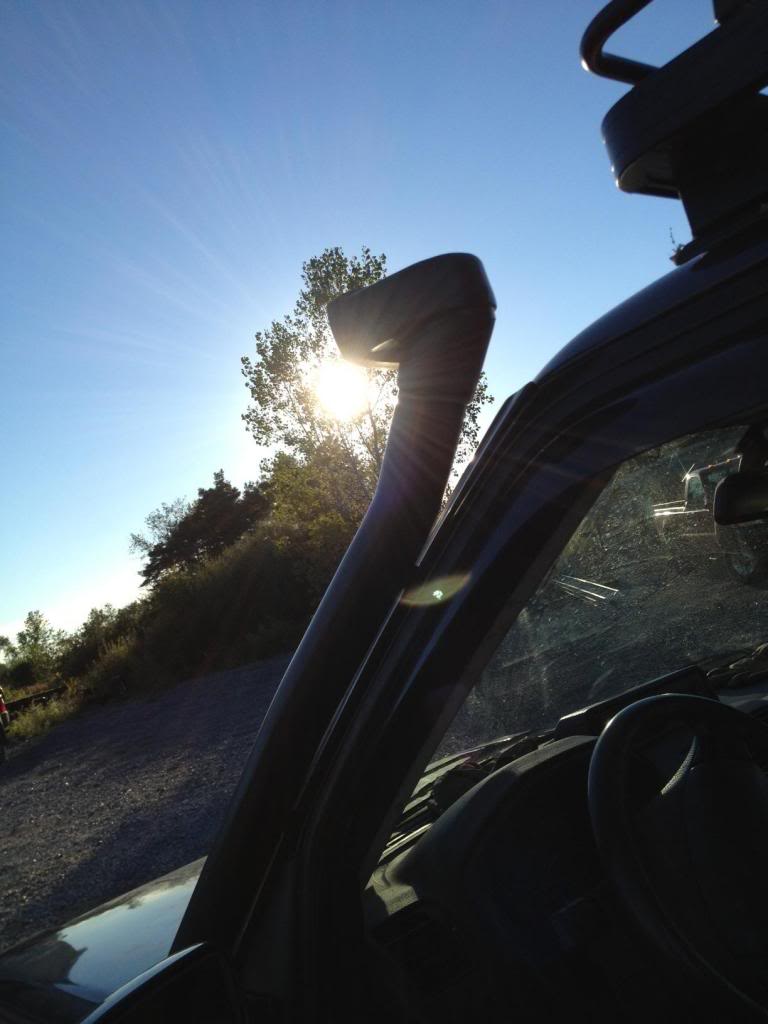

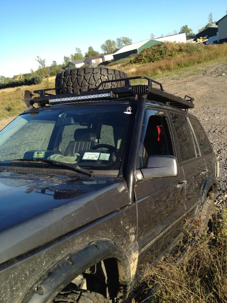

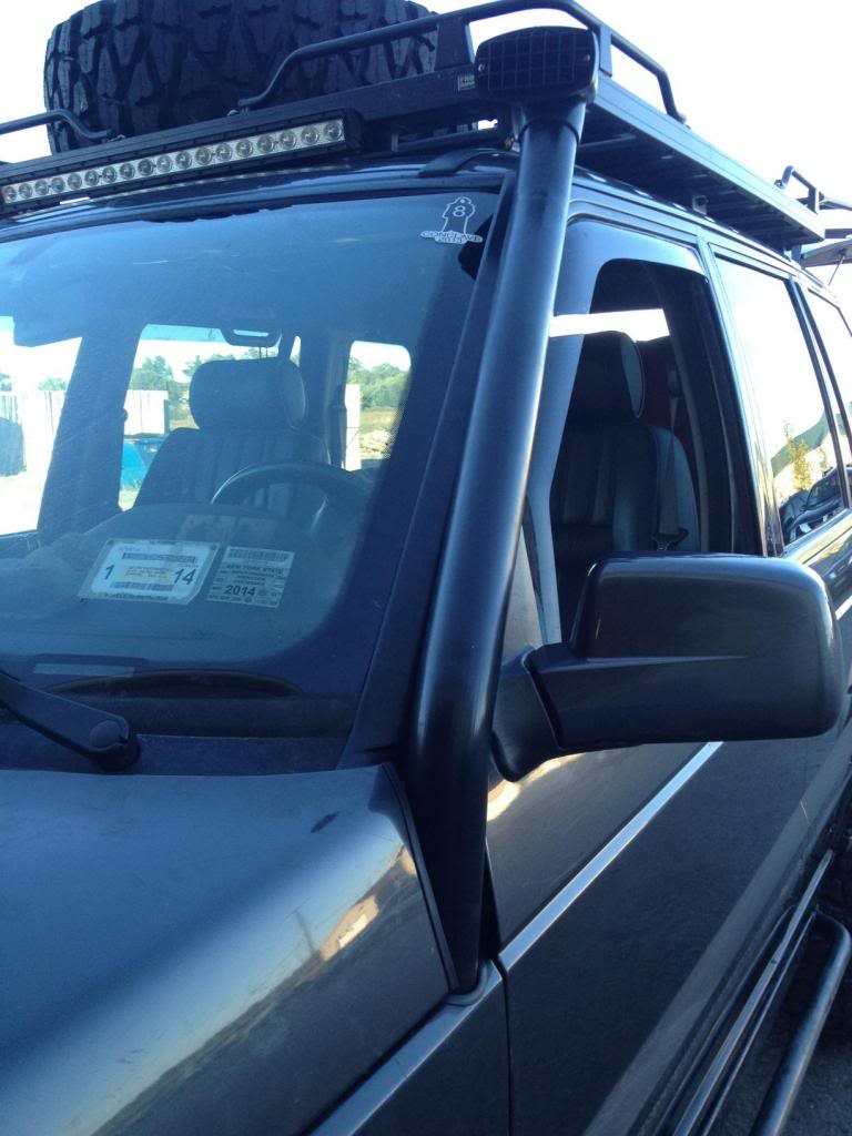

Project update : Snorkel V2.2
I think we are getting very close to a final product. I'm sure your opinions do not need any solicitation so let me have them.
I want to lower the intake head so it is flush with the roof line.
With the top lowered I think it will blend into the truck nicely.

That snork is lo pro and purdy

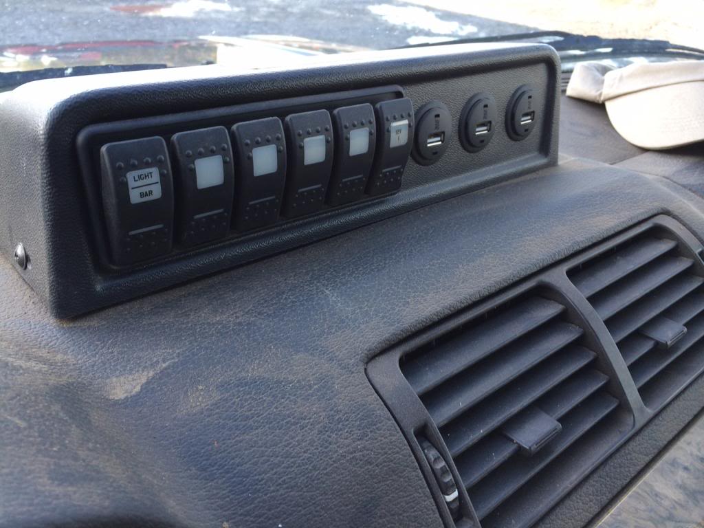

Project update : The space inside

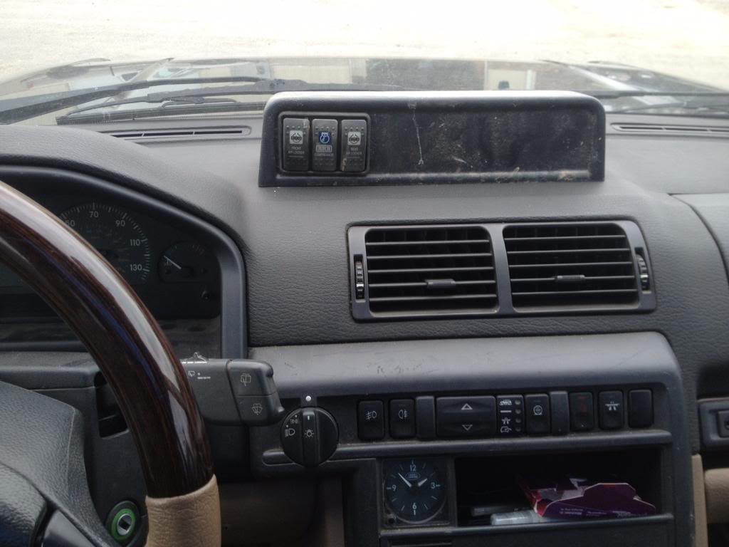

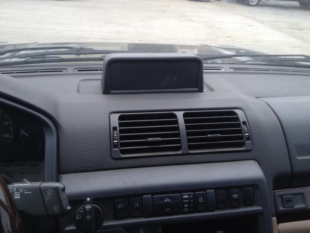

In my opinion the P38 is smaller on the inside when compared to its brothers of the same generation. Finding room to tuck away things is difficult and the lack of aftermarket support makes add ons virtually nonexistent. The issue was finding a good place to mount Carling switches. We needed them to be easy-to-use and convenient to see. Our first idea was to put them in the dash where the original fog light switches are. Unfortunately the Carling switches are larger. With our options limited we hit the shelves and this is what we came up with.
For those of you that don't know, Mud UK produces an accessory pod they call a MUD POD. The MUD POD is designed to sit on the dash of a Defender. The Defender's dash top has a cut-out for an ashtray. The MUD POD utilizes the ashtray hole for mounting and the hole also provides a way to run the wires discreetly behind the dash. The P38 does not have said hole but we will get to that in a minute. The MUD POD comes in two sizes.
Full Size
Or Mini
Just out of curiosity which one do you guys think looks better?

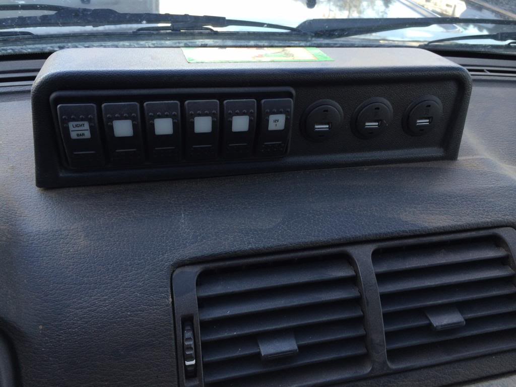

We opted for the full size MUD POD. This gives us the ability to put in as many switches as we like. It also provided additional space for USB ports.
You can never have enough USB ports and we used every one during the VOT.

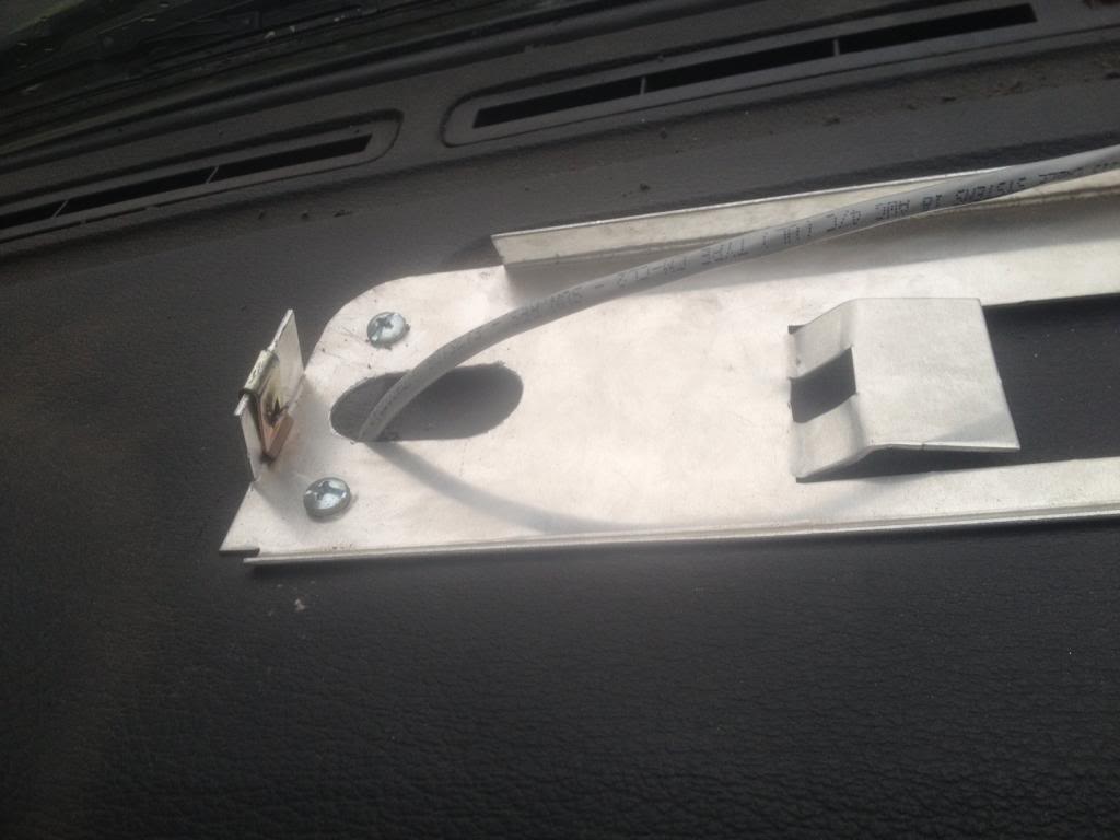

In order to run wires up to the Mud Pod you need to remove the instrument cluster and In this spot drill at an angle towards the cluster.

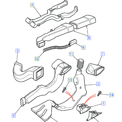

If you're going to attempt this please believe me, use the utmost amount of caution. There's A labyrinth of ductwork beneath the dash

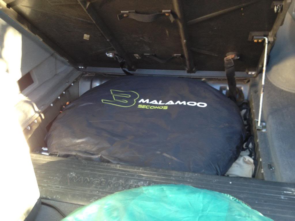

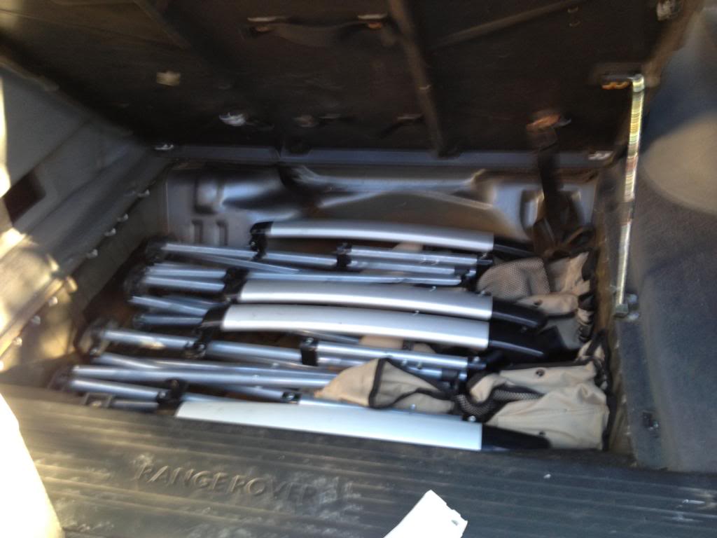

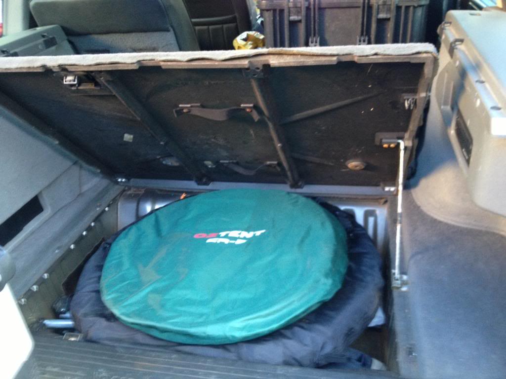

For some extra storage space we looked to the spare tire well that was no longer in use.
Believe it or not there was room to stick two chairs in there.
Followed by a three second Malamoo tent.
And finally an Oz tent shower. It all fit perfectly in the spare tire well.

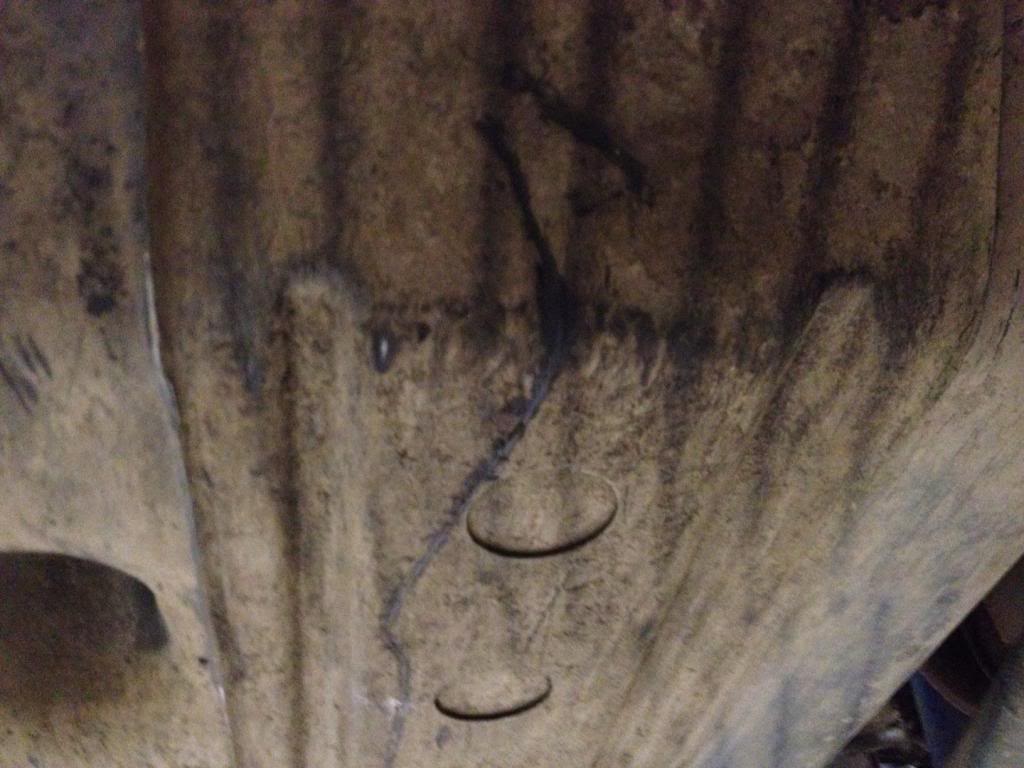

The stock fuel tank holder was getting scuffed and it was just a matter of time before we ripped through it.

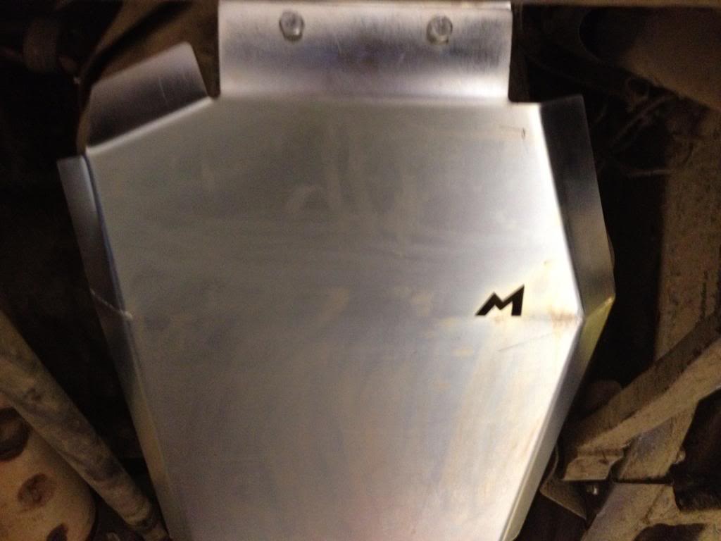

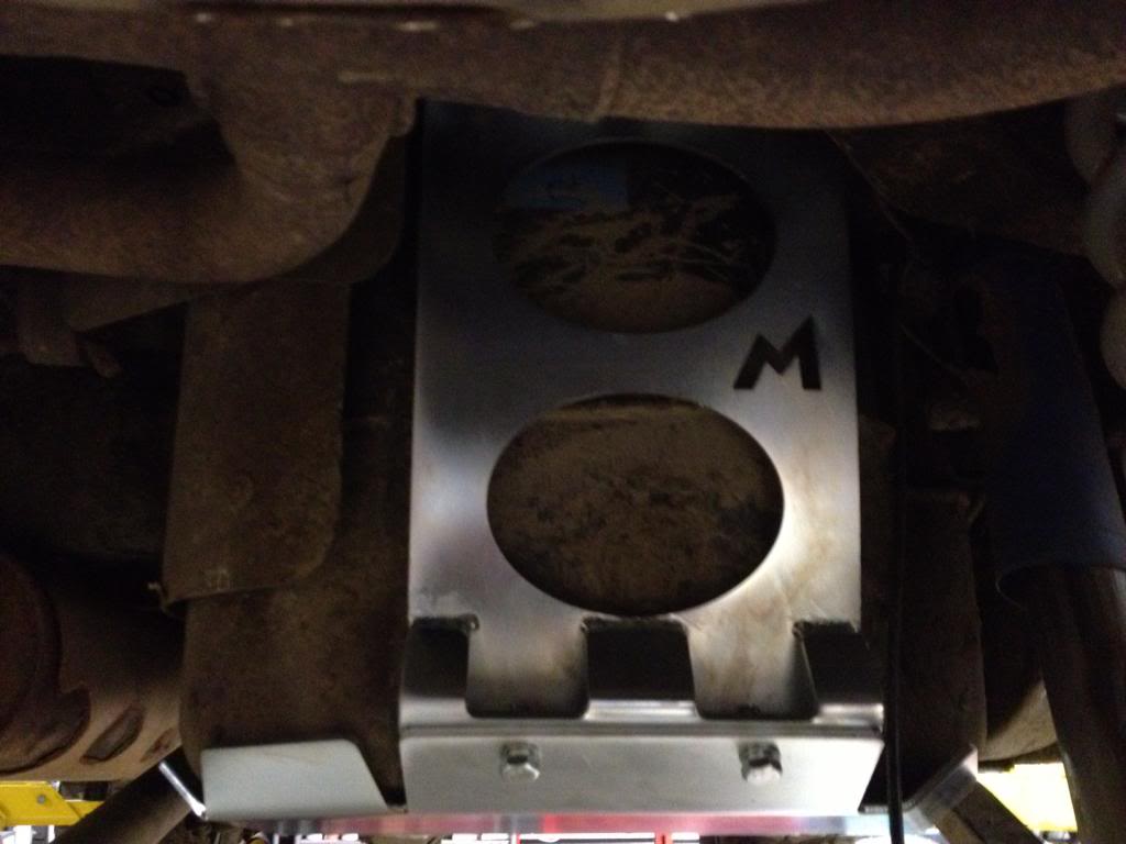

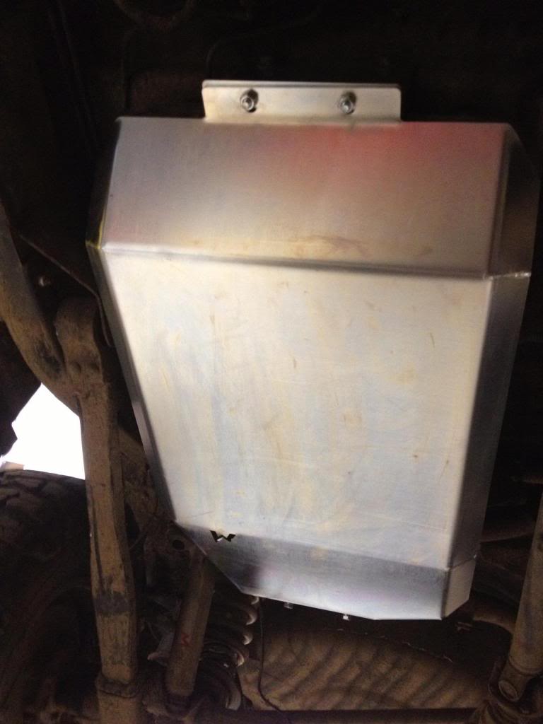

With Rovers on the Rocks just a few weeks away it was a perfect time for the Terrafirma tank guard to show up.
The TF unit bolted into place like a dream. All we did to prep for the instal was run it low on fuel.
The tank guard is available here.
